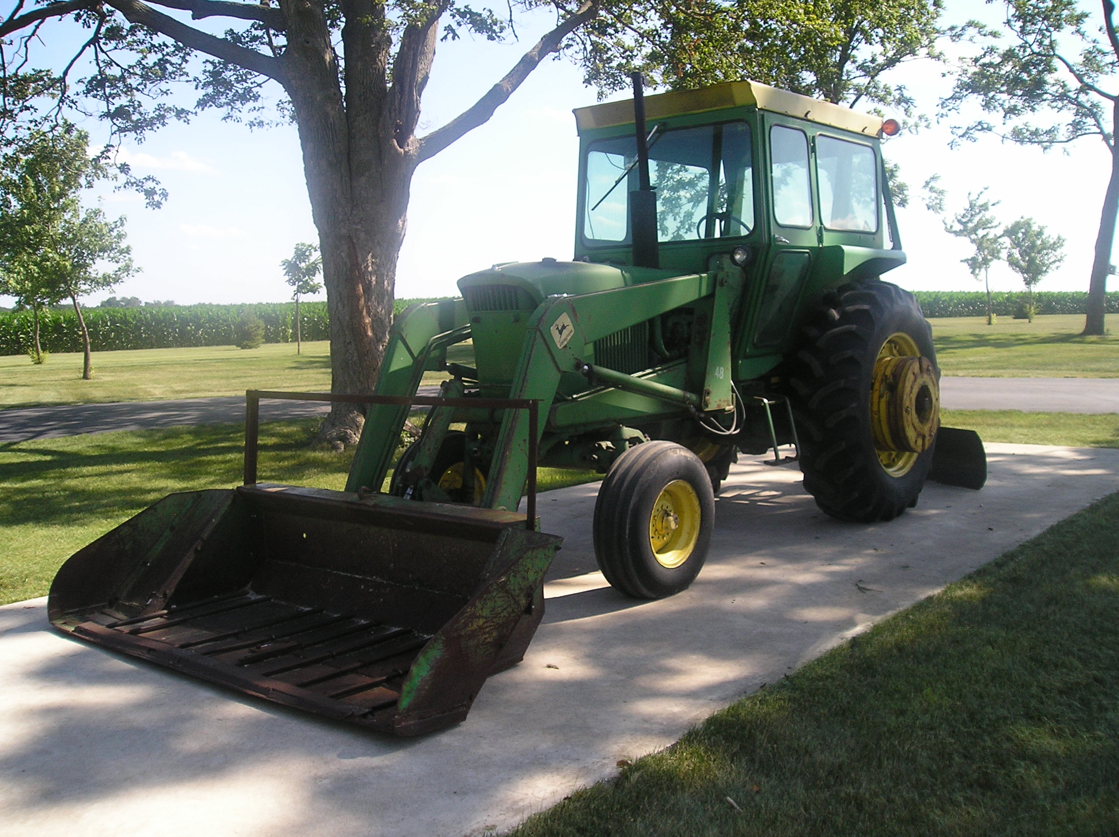

I kept my cabbed 3020 around for snow removal for a few years and finally gave up with it. It was to big to get up close to buildings and it never worked hard enough or long enough to get any heat out of the heater.
