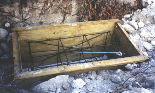

I will be making some tower anchors here soon, that will have a concrete foot on them but the shank of the anchor will be 1" steel shaft, I do not have a place I can take them for hot dip galvanizing, (nor do I want to buy them for the expense factor)
the thoughts I have is to use a cold galvanizing compound on them, Probably do that regardless, (originally I was going to slip some heat shrink tubing on the shafts and shrink it down), but three days ago I found a bunch of used 1" shafting, the problem is on the machine that it was used on had a center bearing and they decided to cut the shaft in half and then weld a tube over it instead of taking the shaft lose from one end and sliding on the new bearing,
since I was planing on running a twin shaft in the first place, my current thought is to add a short section of shaft where ever I have to weld the shafts back together, staggering any splices,
OK that ends the possibility of using the heat shrink tubing, unless I go and buy new shaft,
so I was thinking of sliding a piece of sewer pipe, over the shaft, and after the anchor is in place fill that tube (in the ground) with a cement grout,
what IDEAS do you guys and gals have,
the anchors would be similar to the second one, in the picture, the unit with the double shafts,
http://www.ehresmannengineering.com/Anchor Shafts.jpg
set in to concrete similar to his one about to be poured,
http://www.qsl.net/zf2nt/guy_anchor.jpg
one with the concrete poured,
http://www.rr1.net/users/hwknoebel/anchor.jpg

I've had good luck with cold galvanize spray paint. One thing: from the picture, the steel seems to leave the concrete and then travel through dirt to get to the final length above ground. I would reconsider this, making sure the steel does not touching any dirt (use more concrete). On the other hand, maybe I have misunderstood the picture.
this is why I was considering a plastic (sewer) pipe sleeve and grouting it full of cement sand grout, by do it with a plastic sleeve I use very little concrete to encompass them as normally re-bar in concrete is usually fairly sound even years and years later,
The norm in commercial towers is for the guy anchors to extend through dirt, of course they are hot dipped galvanized.
I gotta tell you BHD considering the scope of the project I'd sure look into commercially made tower rated guy anchors that are hot dipped.
