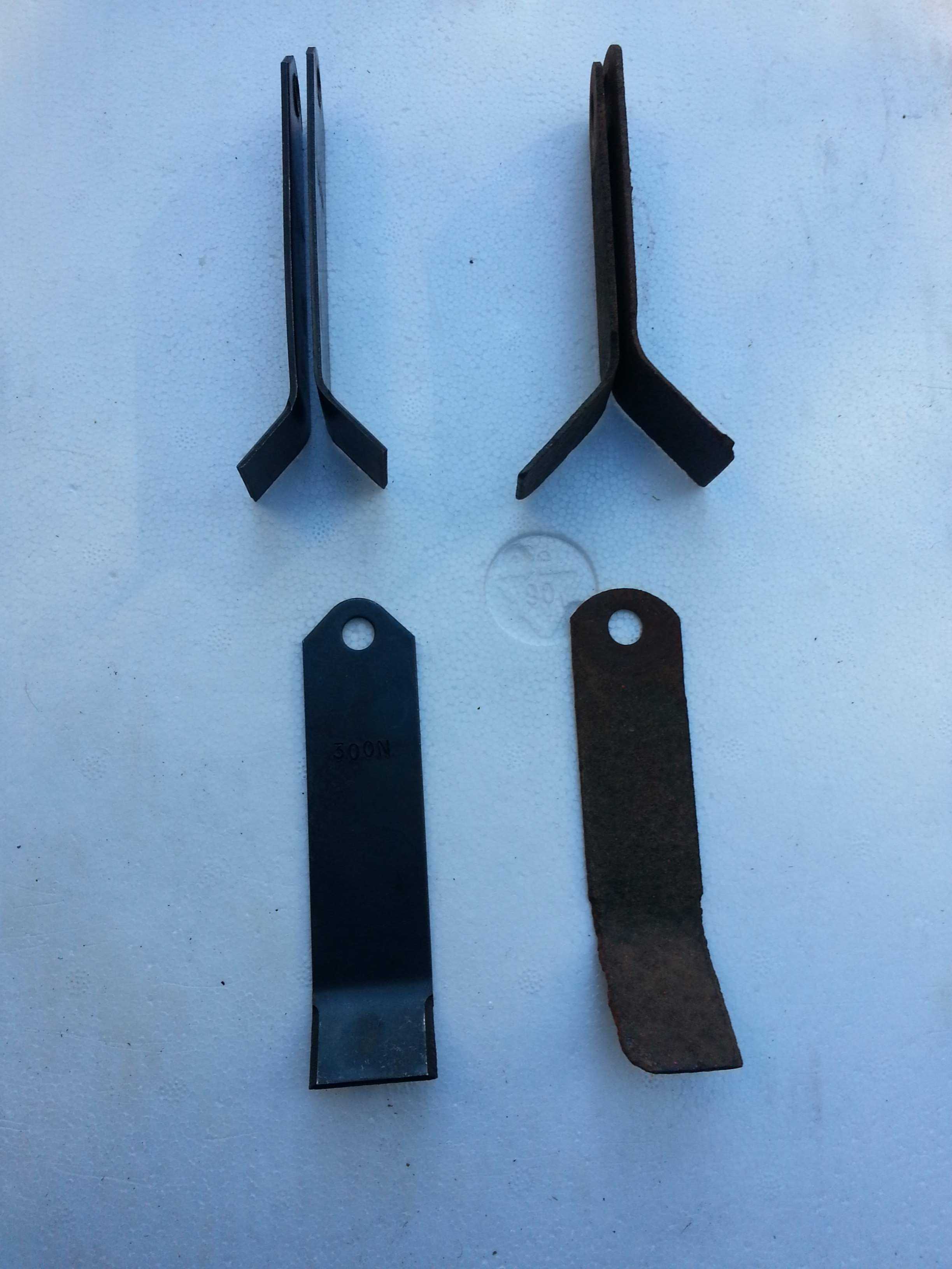

Yup. Don't even begin to negotiate until you see it spinning at the operating 540 rpm. Also, those knives look as if they've never been sharpened. Note particularly the rounded leading edges. They should look like the set below; new knives on the left, neglected knives on the right. And when you remove the old knives, you may find grooves worn in the hangers. If so, they must be replaced as well. Remove the drive cover and inspect the belt(s), pulleys, tensioner, spring(s). Evaluate on the basis of rust and dry rot. With the mower lifted, make sure there is no slop in either rear roller bearing housing. Finally, the photo only shows half of the PTO shaft. If the other half is not available, you're looking at another $150 or so for a replacement shaft.
$750 is a good price, considering a new equivalent would be five times that. But if any/all of the items I mentioned above must be replaced, you could end up with $1500 bucks in this thing before you even start mowing. By example, I got a Ford 917H at a farm equipment auction for $150. And by the time it was actually ready (and safe) to mow with, I had over $650 and several dozen manhours invested.
Don't get me wrong, a flail mower can be a good investment. But what you have to look at is how much it's actually going to cost in the end, once its' up and running to spec.
