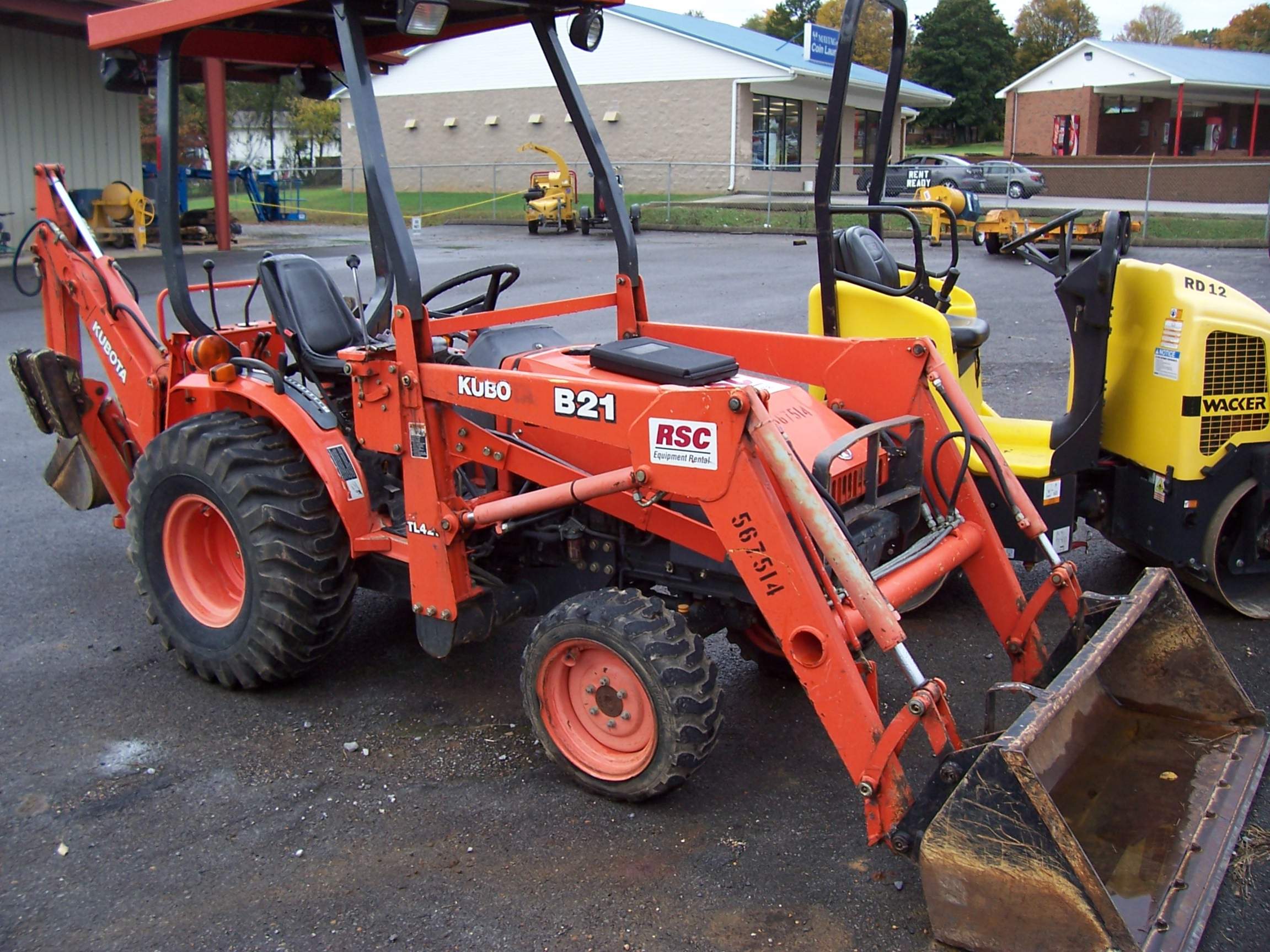

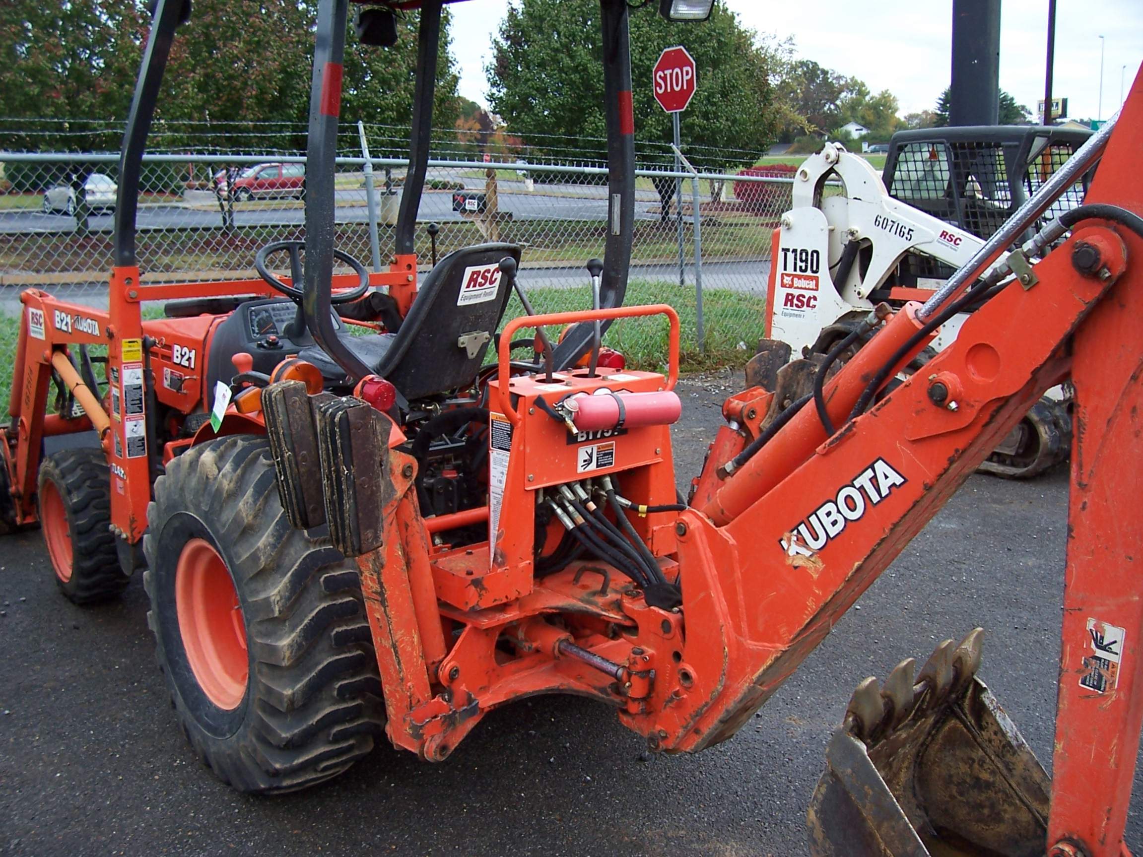

I have the oportiunity to purchase a 2005 B21 rental unit with 250 hours. I have read all of the post about do not buy a rental unit. But with only 250 hours and a 2005 model for $10,500. should I consider purchasing anyway,it would have to have considerable damage compared the prices I am seeing same model and hours, for it not to be a good deal. I have added pictures please give me your honest opinion this is my first tractor purchase.

I think 10.5 K is a pretty good price for a B21 with only 250 hours. I would look it over pretty closely, checking for leaks underneath the tractor and at the hoses. If you have a friend thats experienced with tractors, bring him along and see what he thinks.
Things to look at and for would include; tires, battery, radiator fluid, hydraulic fluid, bent cyclinder rods, and general overall condition of the unit.

Buying rental is no different then buying used. I have bought rental machines and have had NO troubles. I believe what is important is the machines shape. Whether it is a rental or used, you'll need to go over it with a fine tooth comb. Check the fluids not only site but smell, and feel also. Look for damage especially underneath and the hard to see places. Listen to it run, see if anything sounds out of place or loose, take it for a spin. If you aren't sure what to look for take a friend with knowledge of mechanics. Quize the owner see if he is legit on proper maintanence.

My only question is how SURE of you on the hours? It just looks a little too beat up for that few of hours. I know rental units have a pretty rough life, but to my eyes, it looks like a higher hour machine.

The hours seem real low for a rental machine. It seems that most home owner users put about 100 hours per year on a machine. A rental machine should log more than that if it is making any money. Does the hour meter look newer and does it work? It seems like a real good price.
That said I would not be scared to buy a rental unit from a good rental yard. The B21 is a tough little tractor and barely broken in at 250 hours. Mine has 1500 hours and has never been to the shop.
I would check how loose the backhoe is. A lot of slop would indicate worn pins and bushing that I would not expect with 250 hours. Make sure all the 3pt hitch parts are with the tractor they are expensive. I can see the top link mounted in its storage place on the left front loader support. The 3pt arms store on the left frame rail.
