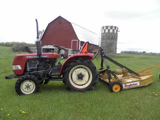

I cut 8' tall hazlenut brush with my King Kutter rotary cutter and a 15hp Shibaura. Never had a single problem.

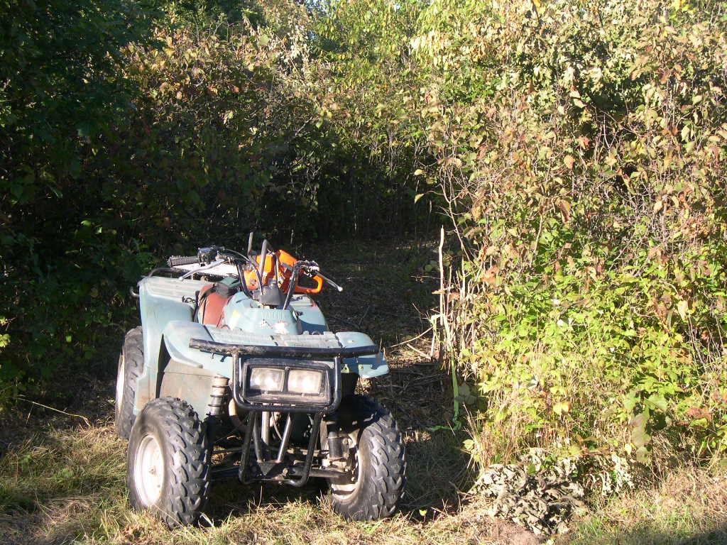

Check out my pic above. I would cut off stems that were > 1 1/2", but I drove right through that stuff to build my trails. It made a racket, but no damage to my mower.
