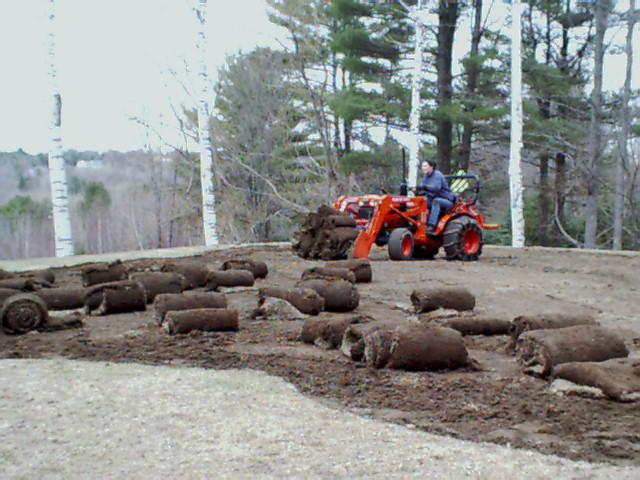

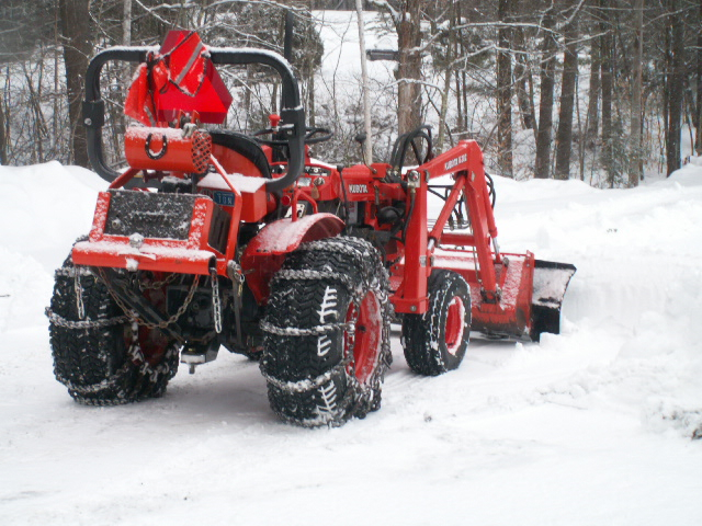

I own 1995 B7100HST for 14 years and it never let me down (y) just wish it had power steering.
