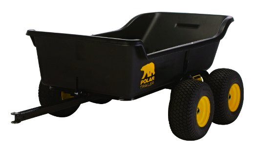

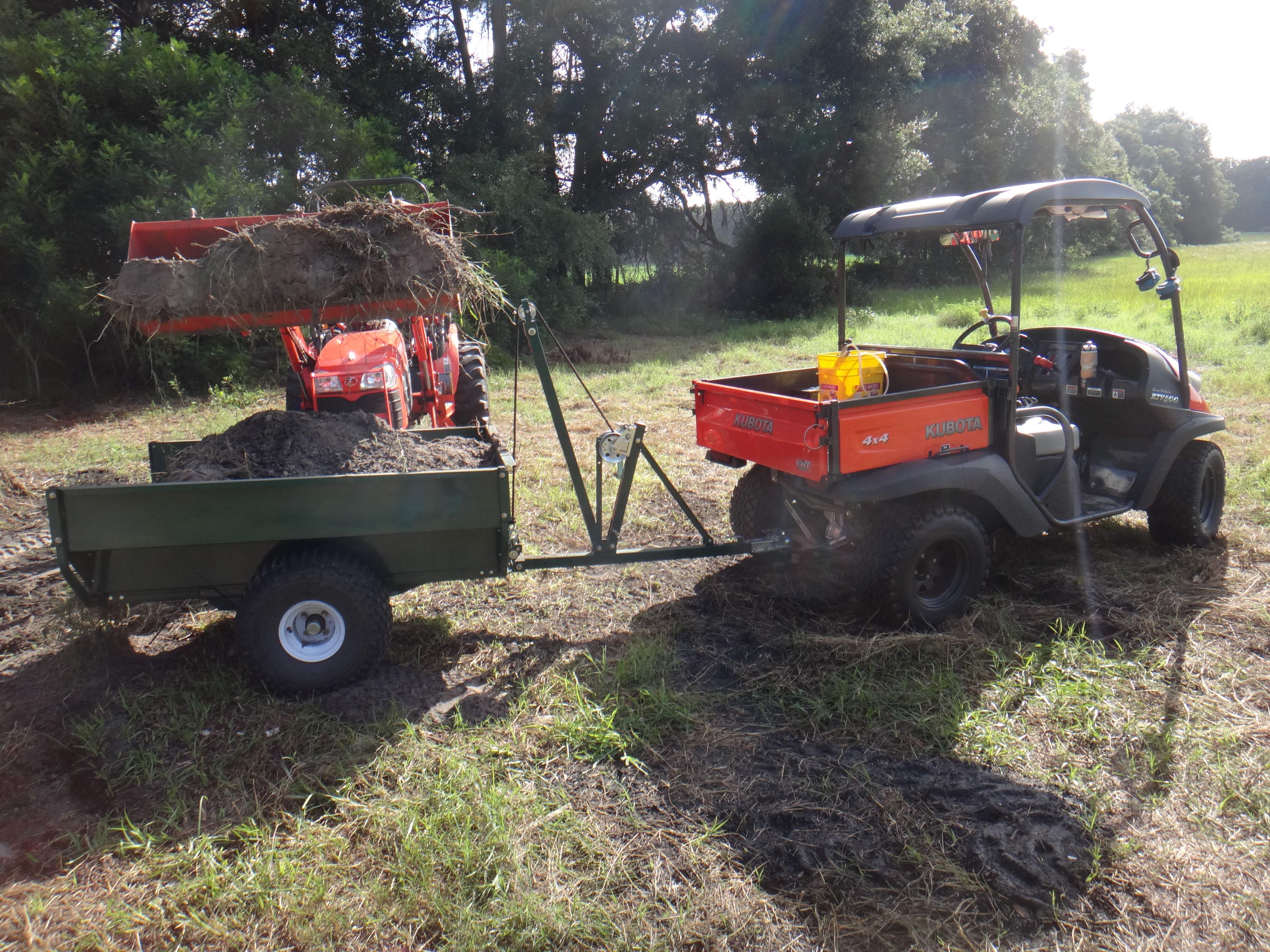

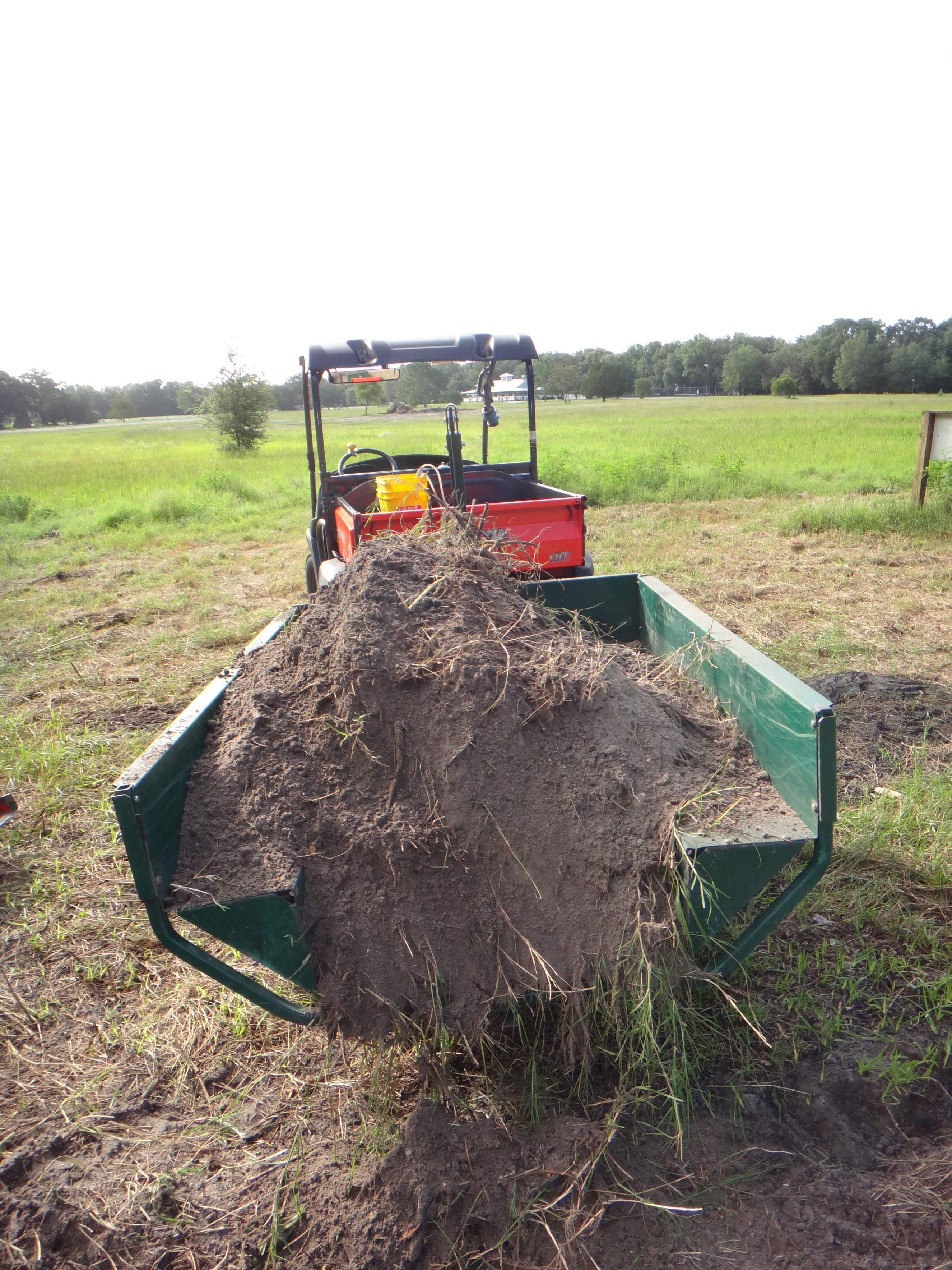

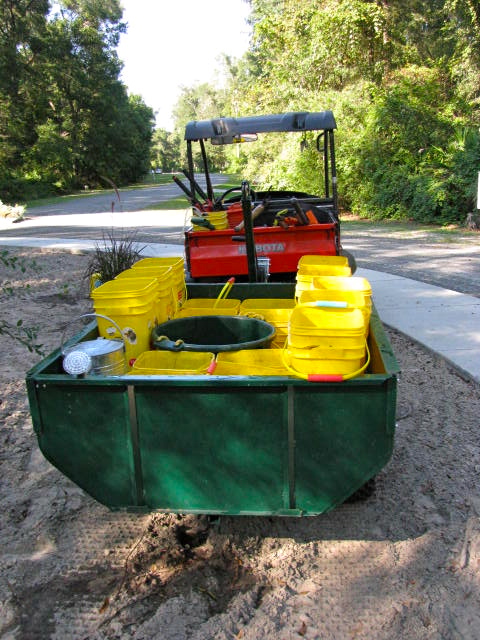

You will need an all-terrain trailer. Gator bed is for tools.
MUTS, which dumps fully, is the gold standard for quality. I have owned a single-axle 'original' MUTS for five years and it represents some of the best money I have ever spent.
You can order a partially dumping Polar trailer from Home Depot's web site. ~~~READ THE REVIEWS~~~
LINKS: MUTS - Multi-Use Trailer System for your ATV, Quad and 4 Wheeler

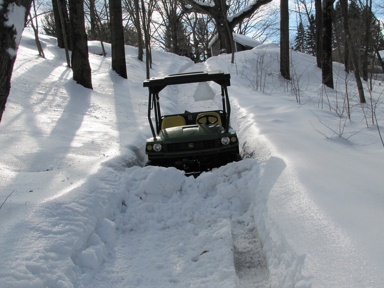

Except for hunting, we do everything you describe on our 10 acre ( about 7 are woods) property with a gas Gator HPX. My wife preferred the HPX to the UTV because the rear bed height was a little lower and she felt that would make it easier to load. We only have a 40 foot grade change, but occurs in less than 100 feet horizontally. That means we have steep road that runs along that grade which I plow with the Gator. The Gator has been bulletproof for us.
I would suggest you find one to sit in to make sure it adjusts enough to fit your height and keep you comfortable.Feb6 003.jpgFromFront.jpg
