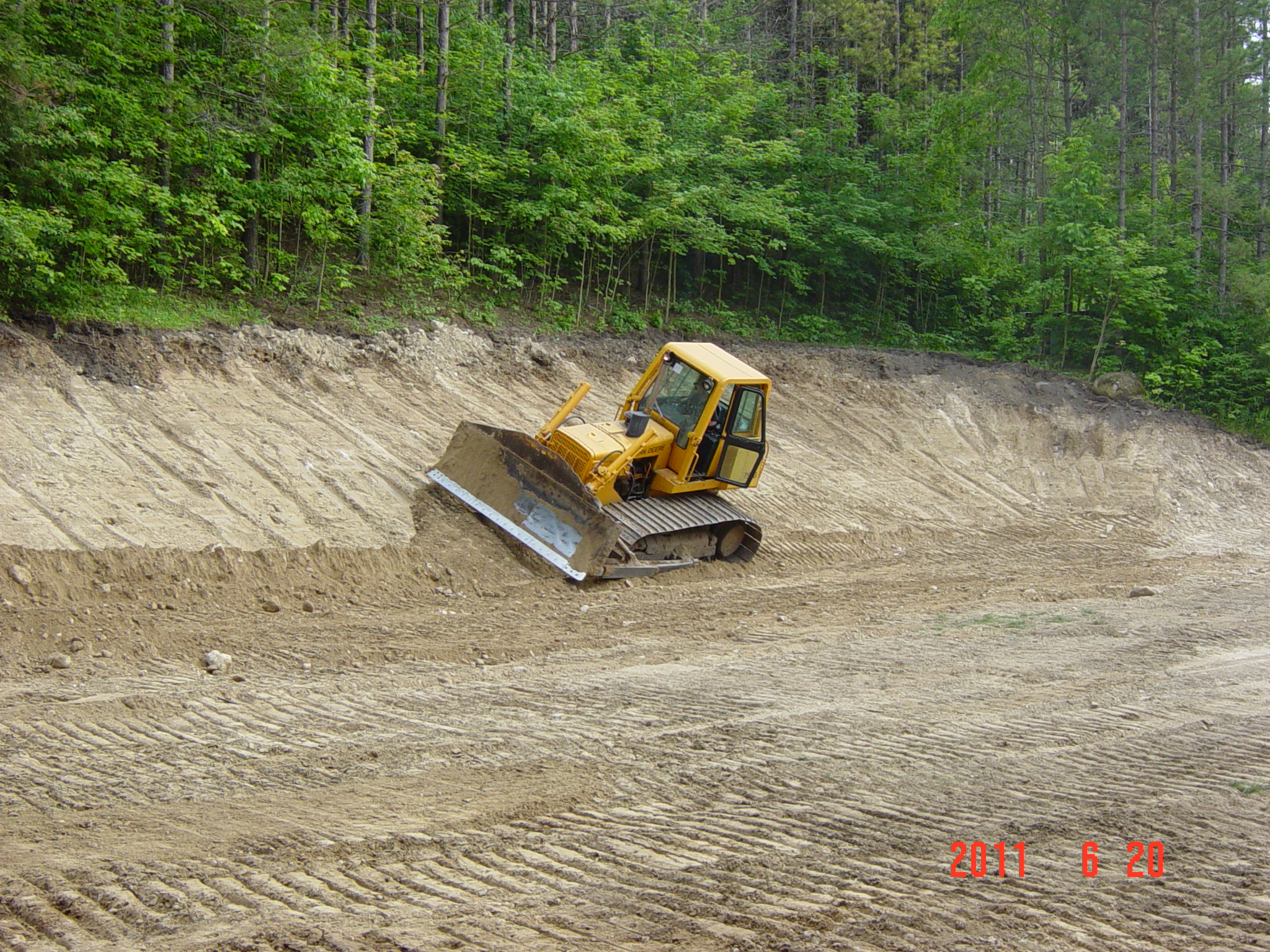

I was never impressed with the 750 John Deere either.
Mechanically I shattered a left rear sprocket with only 3500 hours on it, and then snapped the track in half hence given me my User name. Yep, clearing land on the side of a mountain and went to back up and watched the top of my track go zipping past the window and pile up by the back of my blade. That was a sickening feeling!
I also thought it never had a lot of power, nor capacity. Going a step up to the John Deere 850 seemed to get far more for the money in my opinion.
My wife emotionally attached to her favorite White Pine. (LOL)
