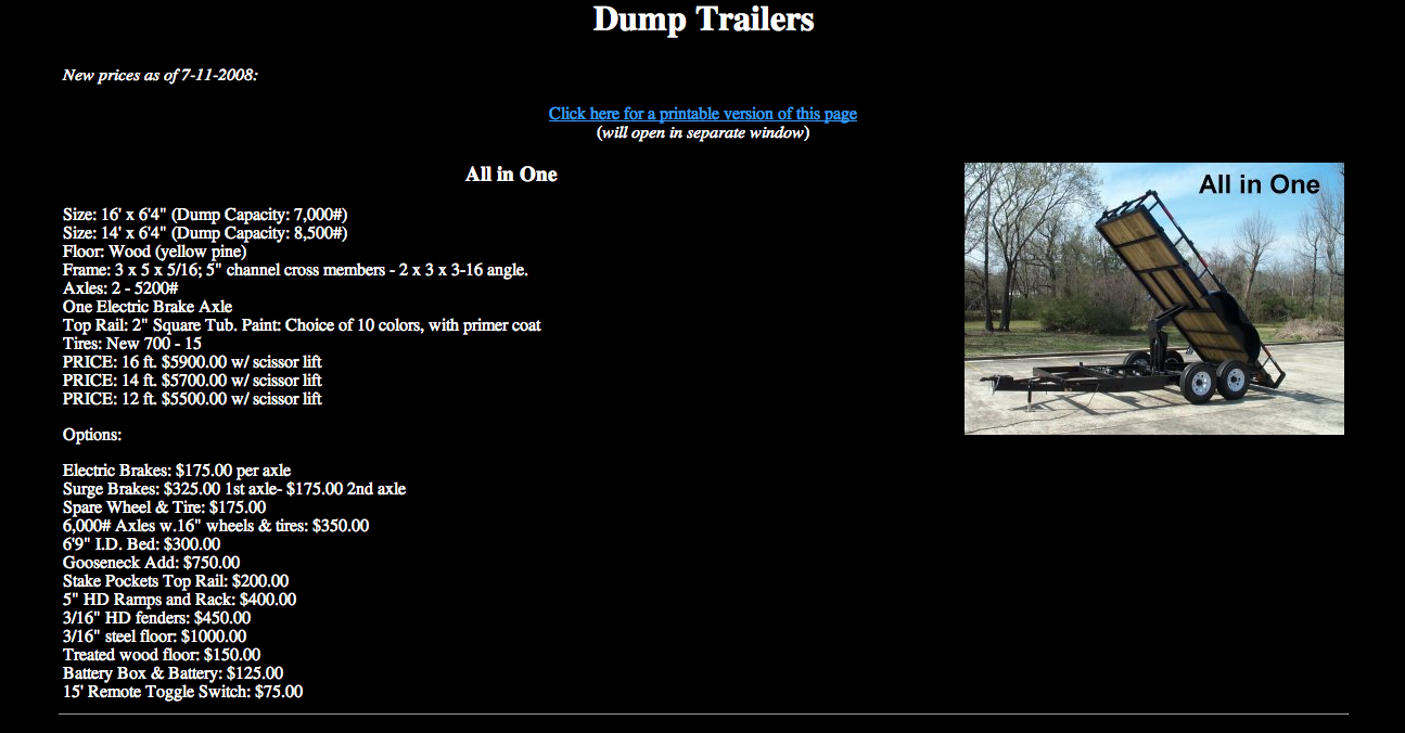

I was looking at dump trailers and found this one. I like most things about it and was wondering what opinions others would have. I currently have a 14' double axle (mostly to haul a Kubota B) and was thinking about getting a smaller dump or getting a larger dump (something like this "all in one") and sell the 14" flatbed and only have one dual purpose trailer.

You can get a serious trailer with all steel dump box and brakes on both axles for a similar price. What are you going to dump that will not tear up the pine floor ? How do you stop the "stuff" from escaping out the sides ?
I would never tow a load of over 8000lb with just a single axle brake.

I agree with brakes on both axles...that is listed on options. Sides could be made to slip in stake pockets. Probably not the best floor for dumping as pointed out. Agree it is a little pricey especially with options listed.

I like the concept, but I think you could get more for your money if you shop around a little more.

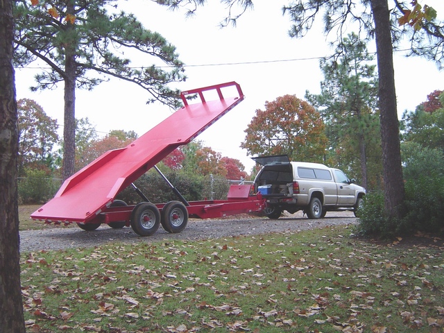

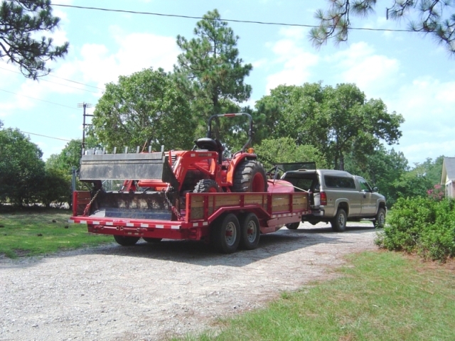

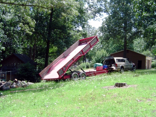

I have one made by BMF Trailers...now called Big Lug Trailers. It's a 20 footer.
That's also another one to check...

Redbug I really like the looks of your trailer and how well it is built. You may have just cost me a lot of money.(LOL) How long have you had your trailer? any problems? How well does it do with dirt? It looks like it would be a very handy addition, compared to a normal 12' dump trailer.

I have had the trailer about 3 years, now. No problems whatsoever with it. I bought it as a flatbed and welded up the removable sides and tailgate, myself. For loading dirt or gravel, I only use the rear half, but with woody debris I fill the whole thing, sometimes 6 or 7 feet high and cover with a tarp.
