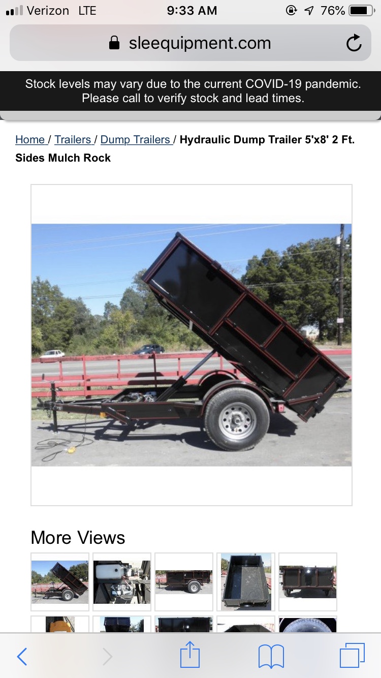

A 3500 pound axle is going to be too light to do anything. Those little dump trailers are pretty common with a 5200 pound axel. There’s a select few with a single 7,000 pound axel which would be my preferred choice. Here’s a 5200 pound one listed for $3400. IMG_9635.JPG
   / Opinions On This Dump Trailer? #8
A 3500 pound axle is going to be too light to do anything. Those little dump trailers are pretty common with a 5200 pound axel. There’s a select few with a single 7,000 pound axel which would be my preferred choice. Here’s a 5200 pound one listed for $3400. View attachment 684814
I agree. The full size wheels/tires would be a major plus as would be the full width. Being able to see the trailer in the side mirror sure helps backing up too.

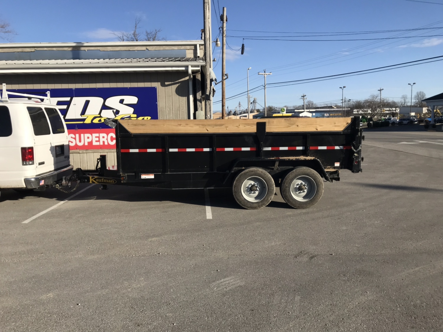

I started out wanting a single axel 7,000 pound to go behind my van to haul trash and ended up with this. IMG_9605.JPG
