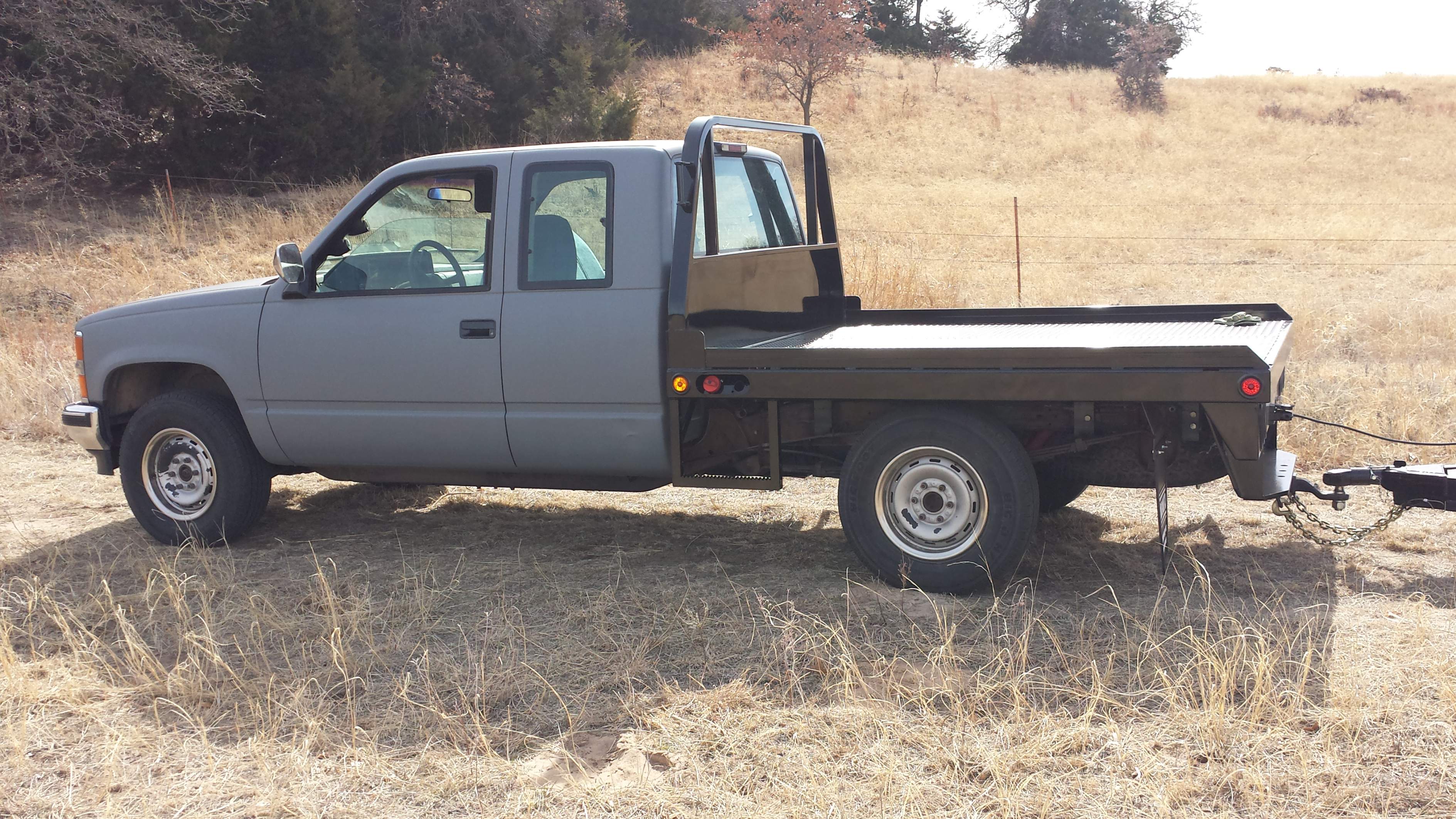

I tow up to 8500 pounds behind my 1994 6.5 TD that I believe was rated to 6000 pounds If you follow engine technology, this motor is crap. It's seen a chip, gauges, a gutted intake and a 4" exhaust straight pipe, an enhanced oil AND transmission cooler (a must with an 4L60 with a low planetary gear count), new rotors and pads along with fresh lines, Firestone airbags on the rear end, and a flat bed welded to the frame that's good to 13000#. Out of curiousity, I hooked the same load to a friend's one ton. It couldn't match my modified half ton on braking , acceleration, and stability.
