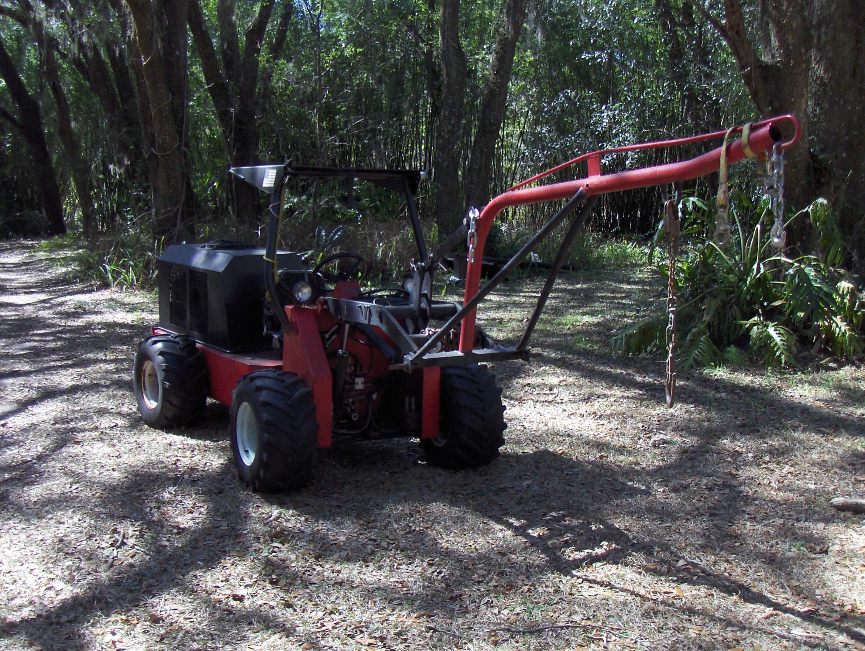

The Power-Trac that I have, uses one hydrostatic closed loop hyd pump to power 4 hyd wheel motors. It uses a 45 HP engine to run the three pumps.
The hydrostatic drive pump also has a gear pump piggybacked on it for the PTO hyd's. The other pump is for loader and steering.
The wheel motors are in a series-parallel combination.
Machine weighs about 3900 lbs.
Although the machine is not fast, larger wheels will give faster speed at a loss of torque.
Are you going to use wheels or tracks? My machine steers by articulation using hyd cyl.
I also have a Struck mini-dozer that steers by braking one side.
My hydrostatic zero turn does just that, it has a hyd pump and hyd wheel motor for each side, and can turn a circle in it's own length.

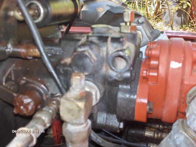

Pic 1 hydrostatic pump plug the red PTO pump.

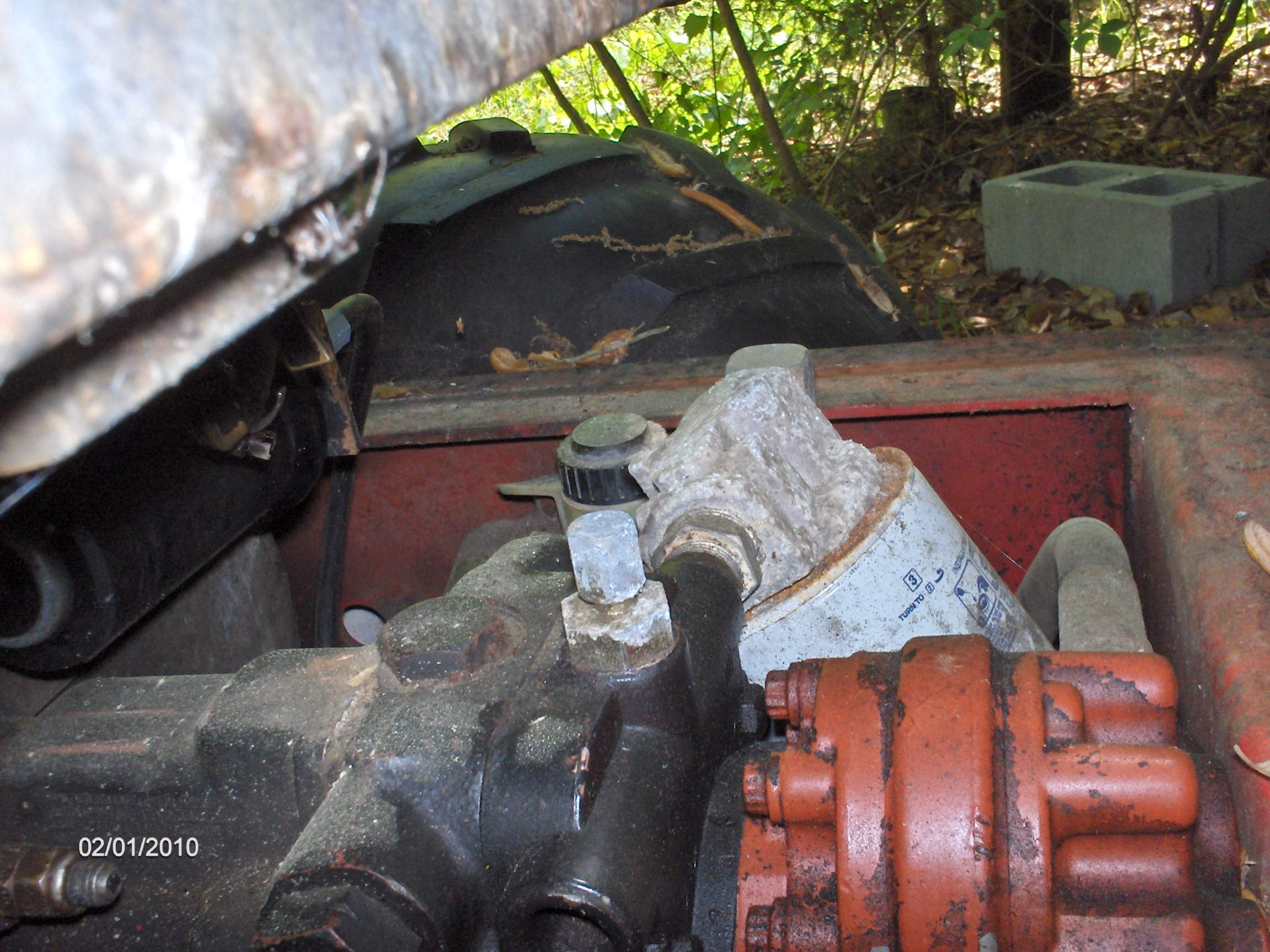

Pic 3 input filter assembly which goes to the charge pump.

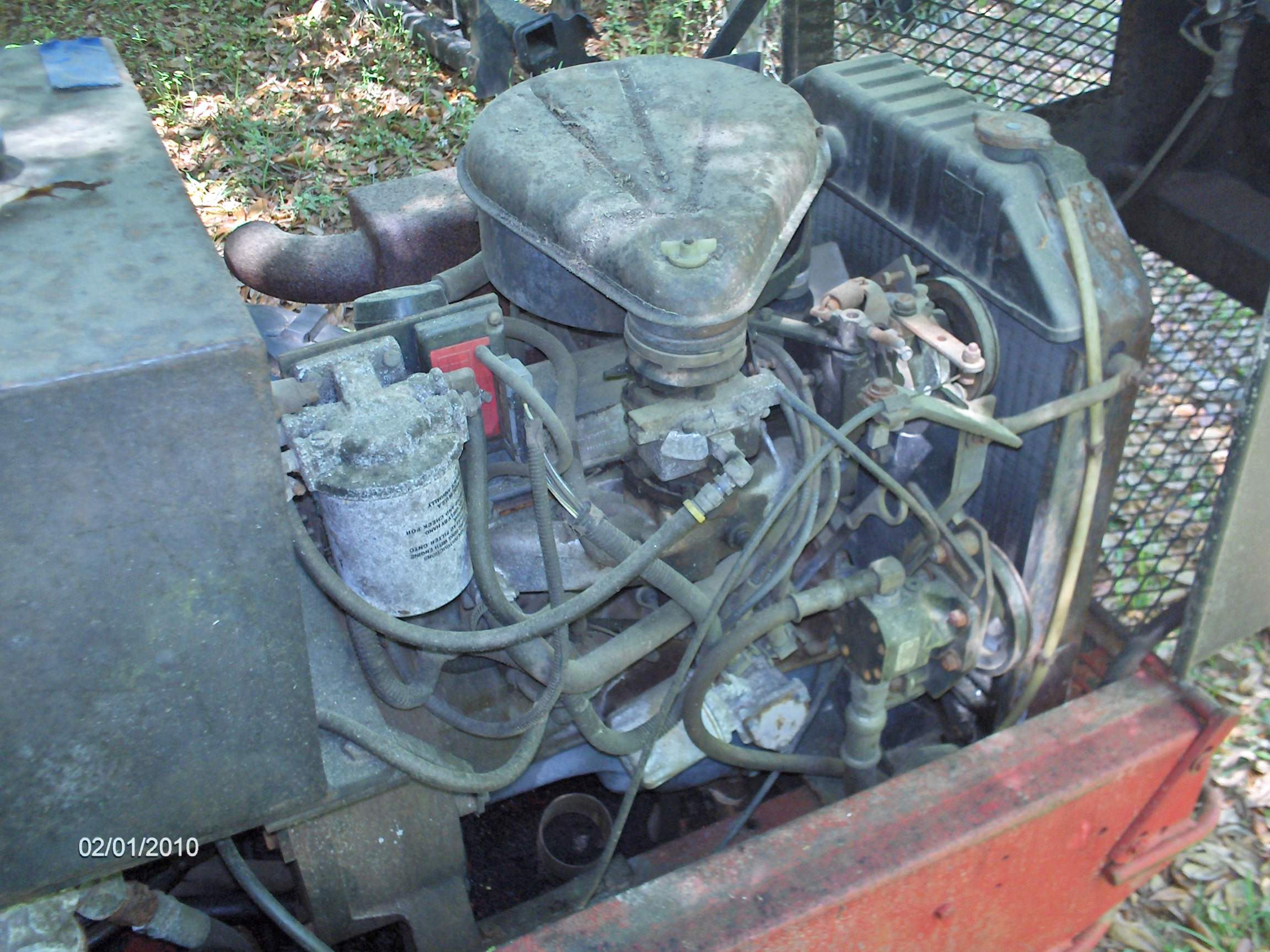

Pic 4 Gas engine 4 cyl, 45 HP Ford industrial eng.
