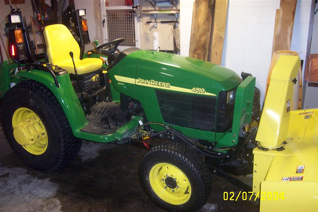

Here's my vote. The JD quick tach is pretty easy to take
on and off. I leave my quick tach bracket on all winter and
then take it off in the spring. I can easily switch from snow blower to FEL in a few minutes. When I am not using the snowblower, I leave it parked in my garage in front of my car up against the wall. When I want to use it, I just fire up the
salamander a few minutes and change it in the warm garage.
Bottom line of course, you are the only person you have to please.

I just now read your private message asking more info about my 59 inch snowblower experiences. I haven't seen a Kubota blower but the JD blower seems heavy enough to me. I have had mine
since 1999 and used it for four years on a 790 gear tractor until I bought my 4310. I only use it three or four times a year and mine still looks like new. I have a 1200 foot long driveway and I have also used it on two neighbors driveways
of similar length. I have had no problem going through
3 to 4 foot high drifts that have accumulated the length
of the neighbor's drive. I think that the blower weighs somewhere between 400 and 500 pounds. The rear housing
of the snowblower has four extra holes for mounting spare
shear pin bolts. I have three left as I have only sheared one
in five years. The blower throws snow about 40-50 feet and
it will stick to tree trunks 10-15 feet in the air. Since I have a white rock drive, I made special sled runners to give me about a 1.5 inch clearance so I don't chuck white rock all over the place. If you don't like the JD snowblower, take a look at Erskine blowers. They have an ingenious driveline setup
that attaches on the rear PTO and runs up to the front mount blower. I have seen quite a few Erskine blowers on the
4510, 4610 and 4710 tractors as the JD 59" will only fit
the 4210, 4310 and 4410 tractors.
