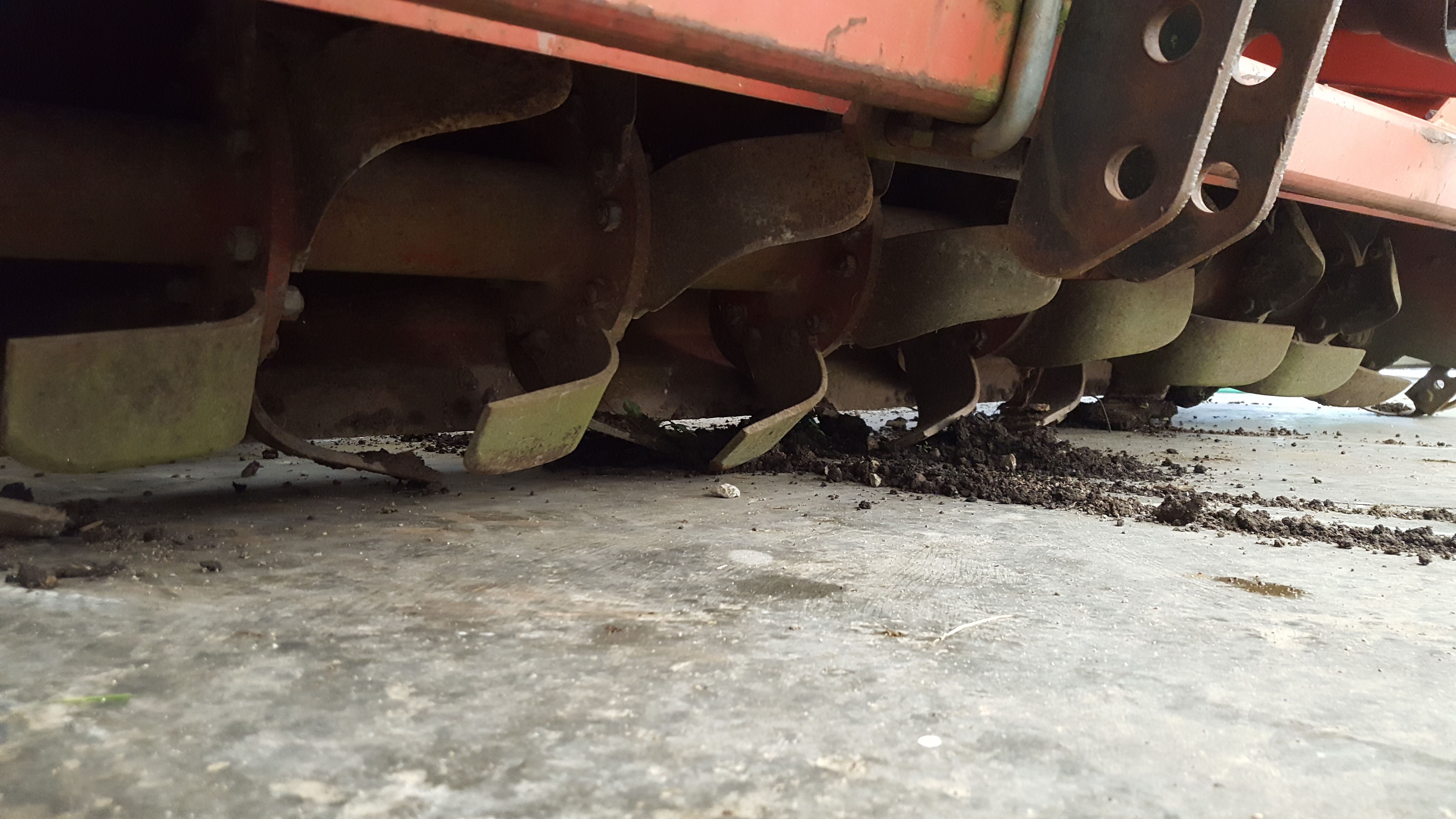

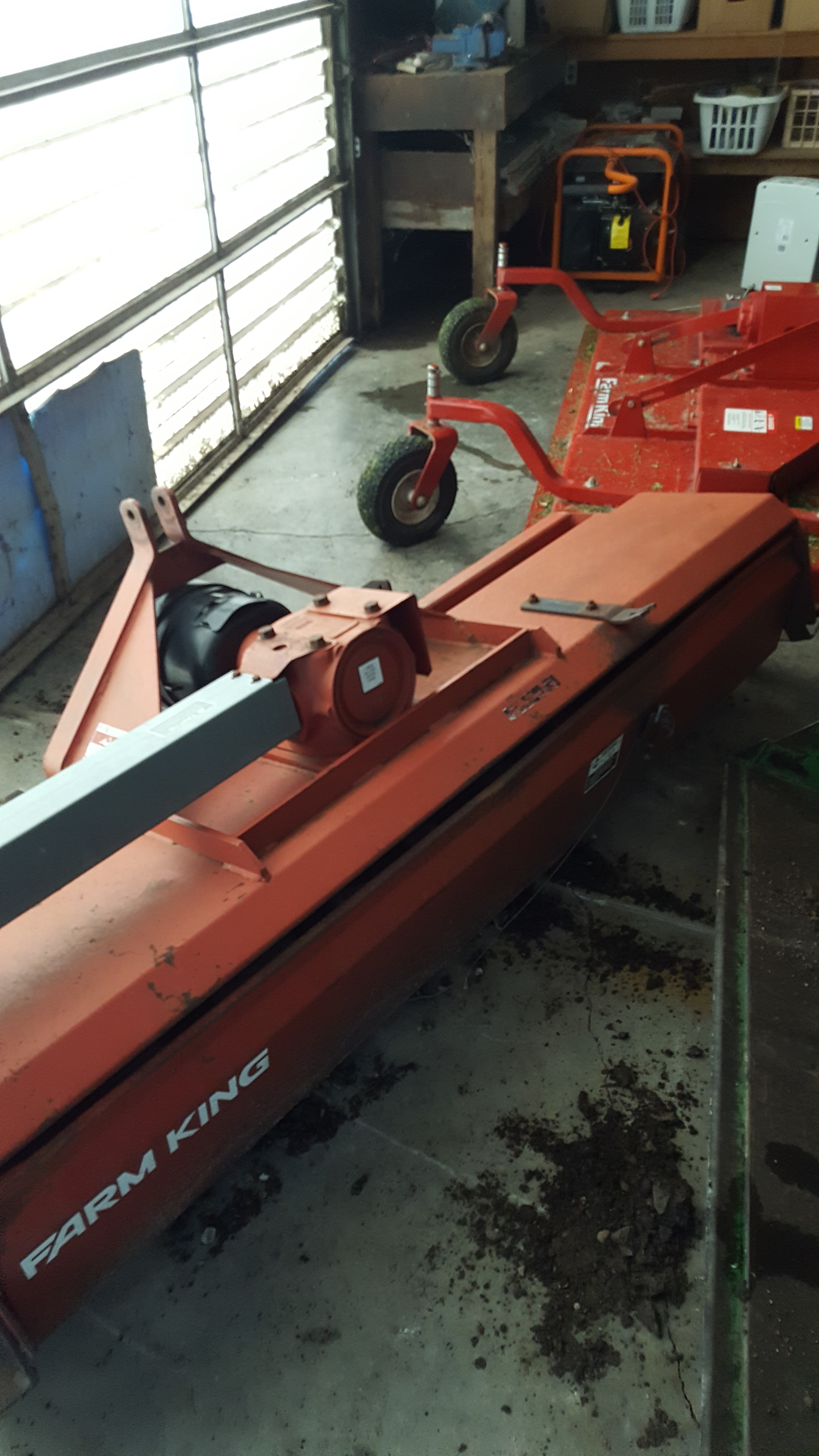

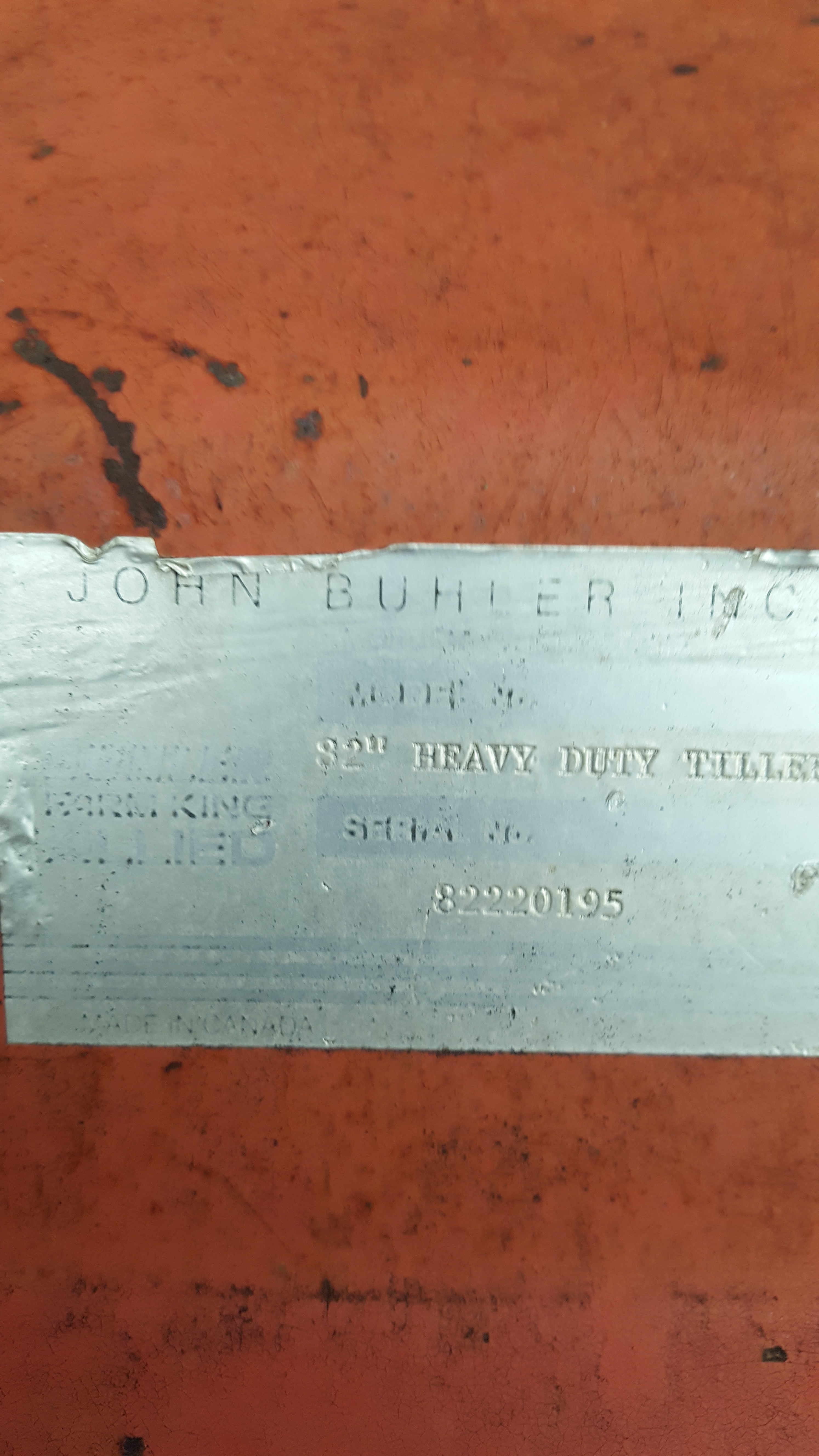

Here's a bonus "what's it worth question" if any one knows... :D I bought my 3520 recently as a package deal and have a 81" Farm King (Buhler) tiller that was part of the deal. Used very little, but of course the paint is faded and so on. Tiller looks fabulous though (what really counts)... I'll attach a pic?? What should I sell this thing for? I had no idea the real "heavy duty" stamped tillers bring so much money in this size. Thanks all!!!
