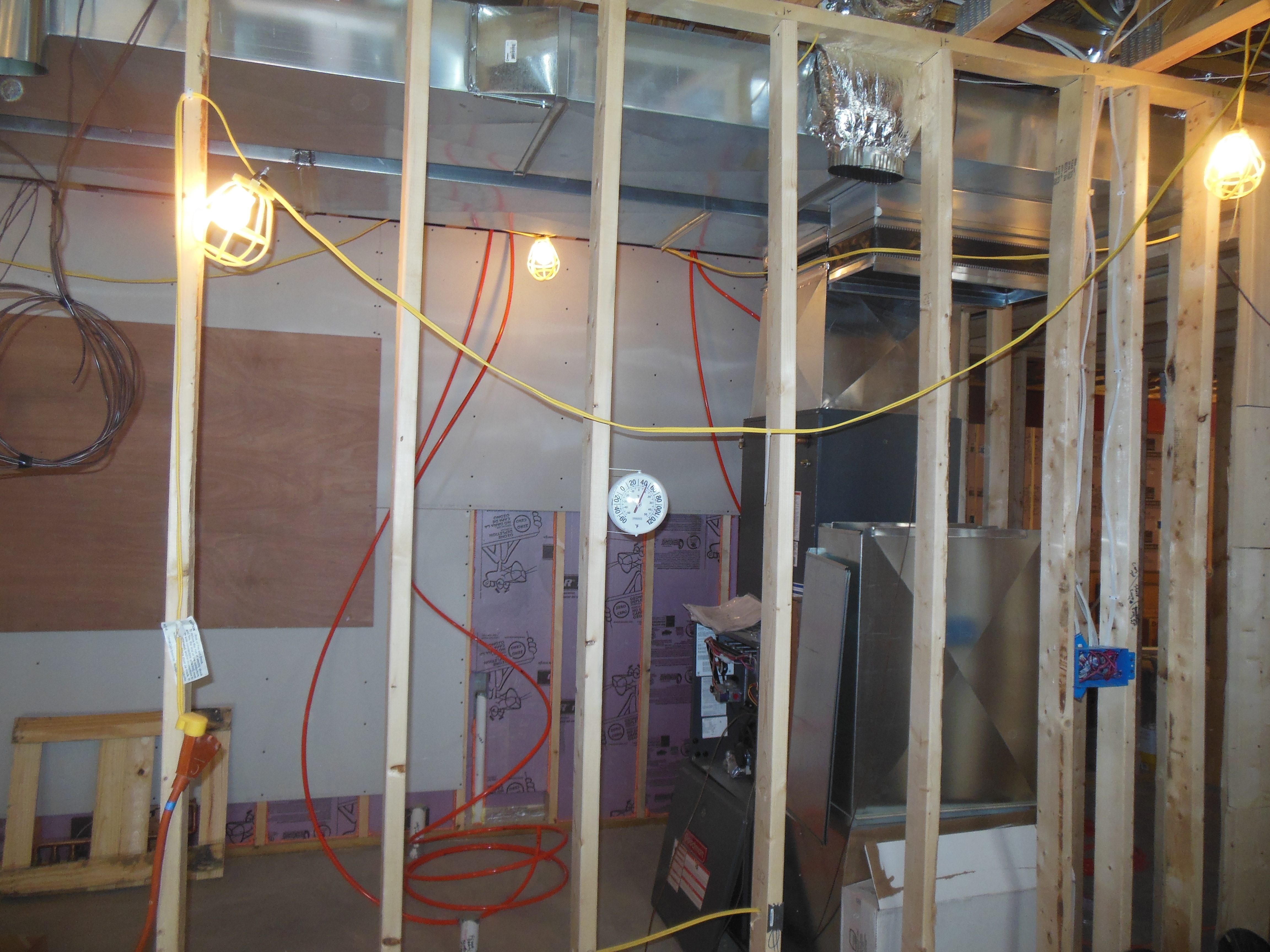

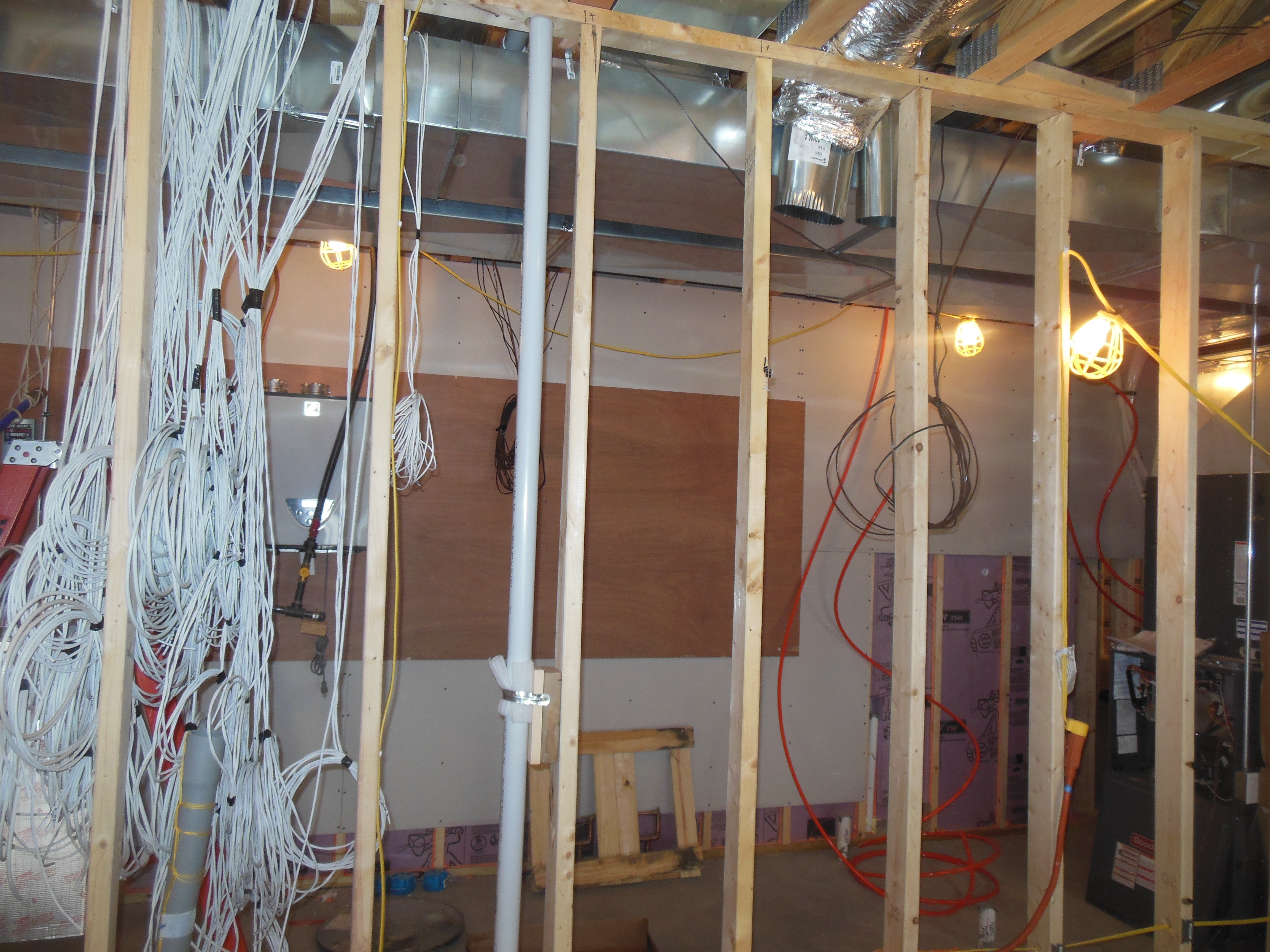

Ha ha ha! You got nothing to complain about... This is all LV wiring...
I ran many extra wires as you never know what will need to go where. Half+ will probably be wasted

Yep, more than half for sure! As I mentioned, the 4 land line phones that were in the house when built have all been phased out and now there's just two VOIP phones-- and most of them are setup on a 2-line wireless system. Presently just one other phone connected via a phone jack.
The main computers are connected via wired jacks and the wifi is used mostly for phones & tablets. However I still want to do something about the ungodly mess of wires-- not quite as many as you show perhaps, but close. :)
What's currently unused sometimes does come in handy when I added some NAS boxes e.g. As I also mentioned, the "extra" video cables often come in handy when I might want to re-route or route back certain video signals.
