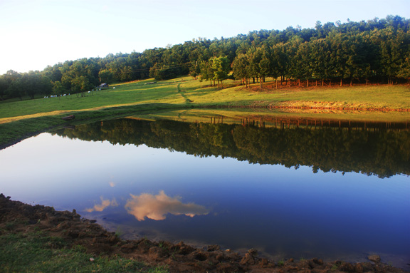

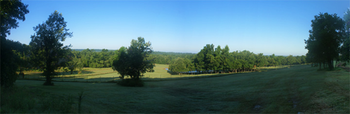

Here are a couple pictures of our property prior to the new construction project.

nice property and nice picture looks like a postcard:thumbsup:
