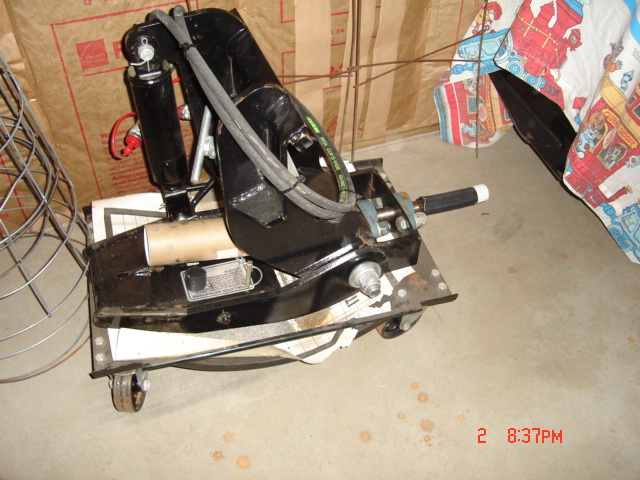

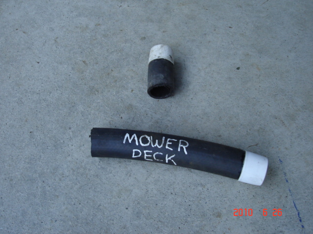

I still use the bolt-on cover for my rear PTO (don't use it a lot), but for other output shafts --mid PTO, MMM,etc.-- I've been using lengths of 1" heater hose with a plastic spray-can cap super-glued on one end. Works well, and the slight curve in the hose holds them in place nicely. Your shafts may be larger than my SCUT's, but I bet you could find some rubber hose to match.

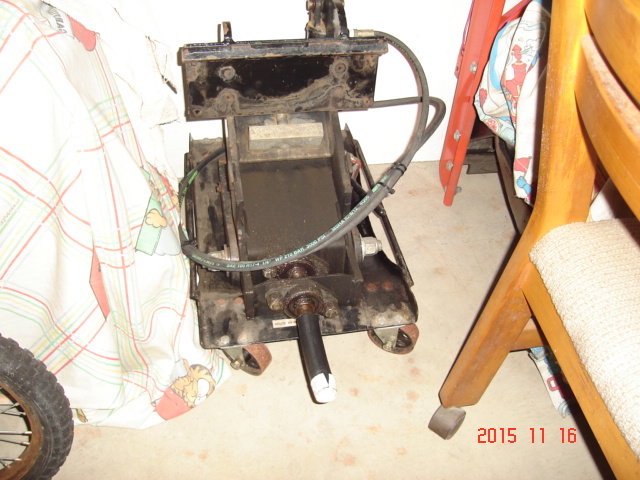

Glad to help! I've even left my rubber hose cover on the mid-PTO when it's vacant, still running the tractor; no problems, keeps dirt & stuff off the splined shafts. Same for MMM and other assorted shafts when in storage. For larger shafts (snowblower), I use a piece of round cardboard shipping tube for storing.
