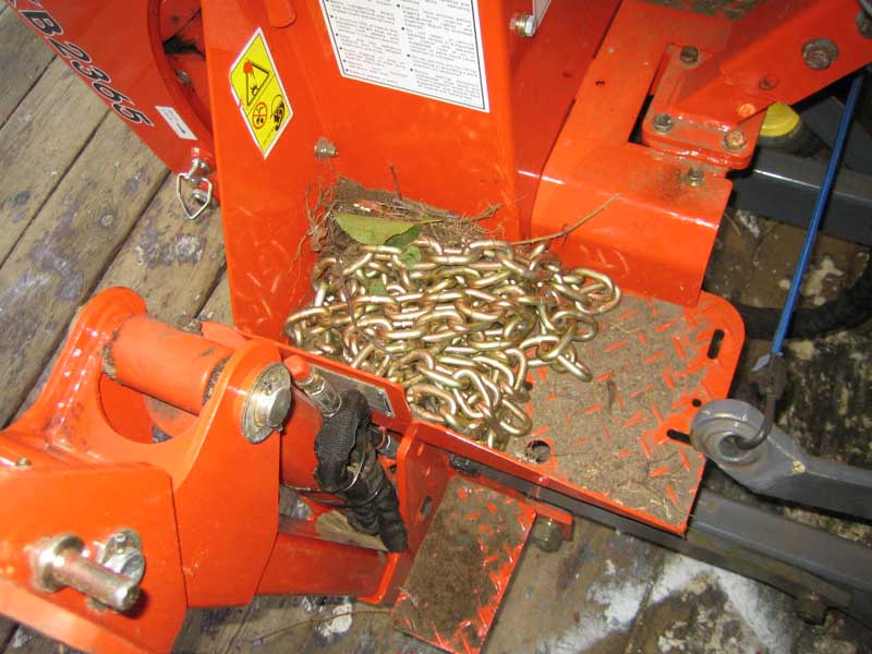

I just picked up a ck20 with the TLB package. I noticed that my outrigger will come up and really give a good wack at the top. I found it this morning really putting alot of pressure on that line. The platform is acutally deformed and caved in from where the line is being pressed on by the outrigger.
Is there a fix for this on the 65 series hoe?
Thanks

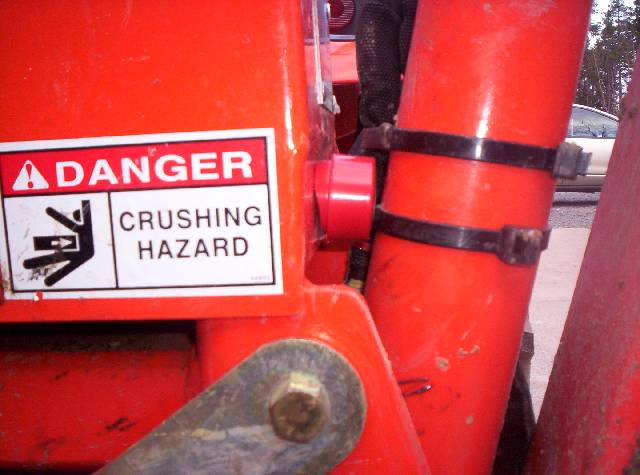

Is this (see photo) the area where the outrigger is hitting the hydraulic line? On mine the lines are zip tied to the side (if you look hard you can see the black ties) so it does not seem to be hit by the outrigger. Are your lines tied in such a way that they are being pinched?

I call it a minor design flaw, but thats part of the learning process. I've learned feather the outriggers when retracting them. I put these on to help but since discovered that I can't put the transport locks on with them on. That was a year ago and I haven't transported it anywhere yet, so I guess its not a problem right now. I also added a couple of tywraps to keep the hoses from being pinched as well.

That is the location of the problem. As I sit on the hoe, the side to my left seems to have barely enough clearnce. The side to my right is hitting at the fitting. I can zip tie the line, but the fitting is mounting to the outrigger and is rigid. There is no way I can see to get it out of the way. I can see any spacer will make the latching mechanism for transport unuseable.
