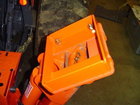

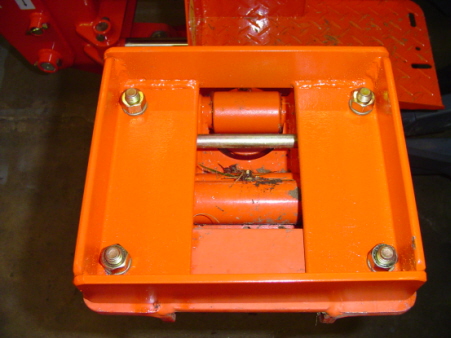

Here are some that I just made for my Ck30.
   / outrigger pads #5
These are made from 2 pcs of 2"x3" x3/8" Angle and 2 pcs of 2"x3/8" flatbar.

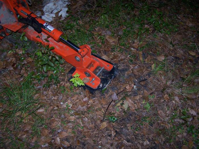

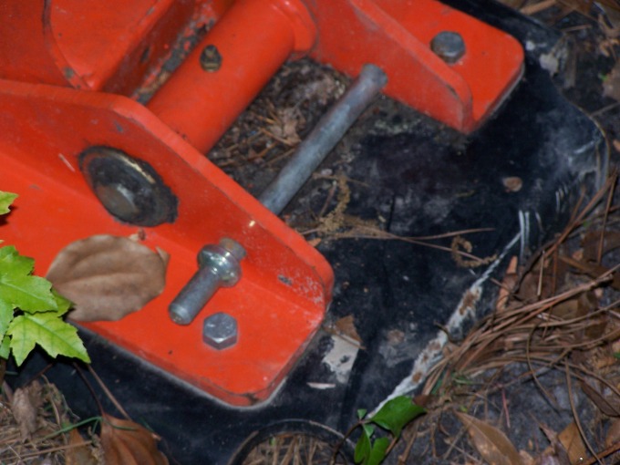

I took these the other day for another thread, but I'll take some with them up out of the ground so you can see all the detail, maybe tomorrow.
Kiotimiike's are square, and that will work pretty well in dirt. Mine are almost "scalloped" with longer protrusions at the corner, to dig in better.
