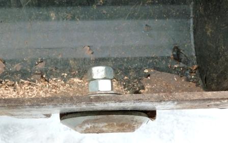

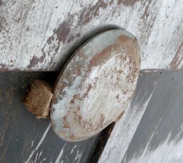

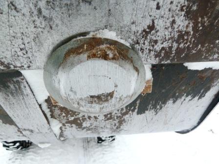

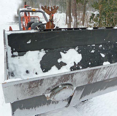

Anyway, here are pictures of the skids. I think I bought these:
FREE SHIPPING SnowBear Skid Shoes (Pair) 5in. Dia. | Snowplow Replacement Parts | Northern Tool + Equipment
though not sure. I *am* sure I only paid about half that a couple of years ago, so perhaps they were on sale someplace.
To mount them, I used a Greenfield punch to expand the outer two tooth-bar mounting holes. You can see the high-class wood shim I use to keep them square. I shortened the threaded stub; kept enough for two nuts just in case. I'm surprised at how quickly the pads are eroding - looks like this third season might be the last. (Note separation line in one photo.) I suspect that they're made out of ordinary steel, not the self-hardening stuff used for prison bars and sandblasting boxes, or the alloys used for excavator teeth. Disappointing.
While they last, they do the job well, letting me use a slight dig angle on the blade without diving into dirt/gravel, or scraping blacktop. Frankly, though, the loader blade is not very good for snow; if I were feeling richer, I'd get a proper rear plow blade for the TPH, and use the loader mainly for the icy berms the town plows leave.
