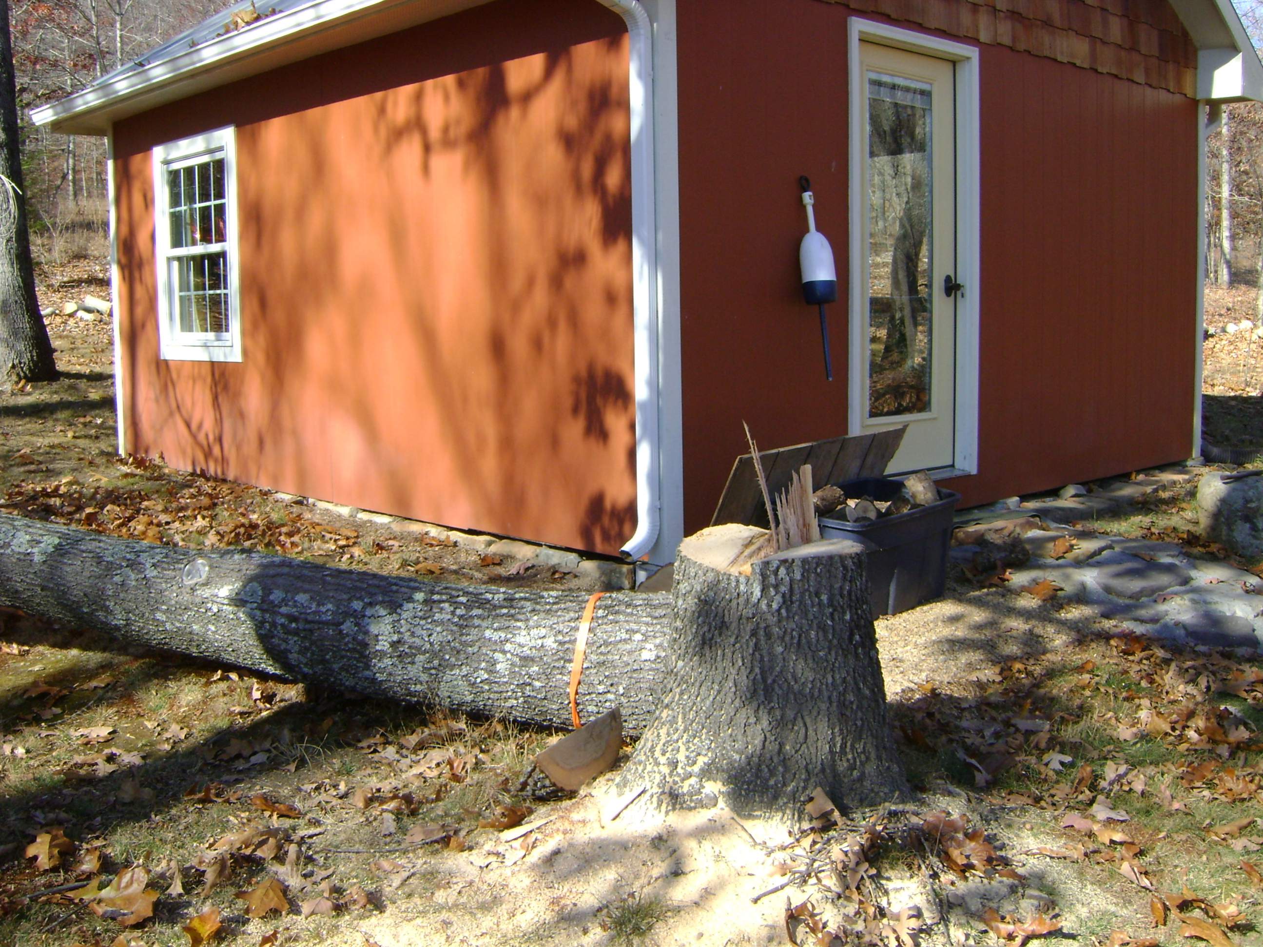

Ha Ha, Your right. What a mess 12 Gals can make. You only do this every 400 hrs, so I forgot how fast it comes out. It got to be a comedy of errors. First a five Gal bucket, then running around looking for another clean bucket,meanwhile,oil all over the floor. So I didn't refill enough, cutting a 60ft red oak, 5ft from my wife's studio. Cut my notch, go around back of tree start doin the back cut, tree is also leaning the wrong way. 100 ft. double braid line pullin with tractor uphill, with not enough fluid in hyd. tractor won't pull, run down to the barn for more fluid , meanwhile tree is holdin on by a tread. Fill er up, start pullin, tractor couldn't do it in Mid range, had to get in low range, finally down she comes, a perfect fall, but MAN, what a pucker moment. Couldv'e hit the studio, and our house. I've got some pics, but I can't seem to make it work

Ya, that would be an exciting day. :laughing: You dodged a bullet there for sure.
   / Overfilled Hdy/Trans #13
Bet that got your heart pounding!

Wow, that was close to the building!
