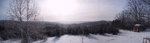

I have about 1600 christmas trees that were planted at various times over the last 15 years, spread over about 4 acres. I bought the property in 1995, and have only half-heartedly kept them up. Most of the trees are overgrown now, ranging in height from 12-30 feet. I have Norwegian Spruce, Blue Spruce and Scotch Pine. The rows are too close together to get my JD lawn tractor down.
My back deck overlooks a valley, and the Pines are threatening my view. I want to get them out of there before the grow TOO big. I still want to grow christmas trees, but fewer, so that I can keep up with them myself, without hiring a crew. My question is what should I do with the trees? Last year I pulled about 300 of them and piled them up. This took a solid week with 3 guys, and now I have no more space to pile them. In a thread from back in March called "Which is the best way to clear land", Billc said he was going to cut and sell the pines. I think Billc's profile says he lives in GA. Does anyone know how I would go about selling them in upstate NY? I think they are too small for pulp, but I really don't know. Could I sell them to a landscaper? Would the landscaper spade them out?
If they turn out to be difficult/impossible to sell, should I continue to pull them? It is much easier than cutting them with a chainsaw. Digging holes with my new Kubota 2710/backhoe seems like it wouldn't work, just becuase there are so many of them - their branches tend to make them pile up high. The hole(s) would need to be HUGE.
My first preference would be to get someone to take them away for $$, and grade the land when they were done. My second choice would be to have them removed and graded for an even trade, and my last choice is to do all of that work myself and then have to find somewhere to put the cut trees until I can burn them all (whew). What do you think, can I get some money for them? Some of them are "knarly", but most of them would really make nice mature landscape trees. Any suggestions would be helpful.
I've added a panoramic view from my back deck of my trees, so you can see why I want to keep the view. You folks from warmer climes might not recognize the white stuff on the ground/w3tcompact/icons/cool.gif!

Paul,
Would it be possible to dig up some of the trees for transplantation? I have been looking for some large trees to use as a screen between our property and the neighbors. Their house and property is not too pretty! :^)
We are also located in upstate NY, Schenectady and our land is in Valatie. Where are you located in NY? If the price is right we could come and pick them up. Are they too big to survive transplanting?

Paul, I sure would be contacting some Landscaping firms, Nurserys, local Horticulturists, etc. I know I have seen Maples etc pruined to 30 foot height and transplanted to various properties as part of the landscaping done in new construction. They have even developed large equipment to take the trees out of the ground complete with rootball to load on flatbeds and relocate...
Best suggestion is to put out feelers before you throw away a cash crop!

Sorry for taking so long to respond. I am located in Vestal, NY, near Binghamton. Just a few hours drive down 88 for you. I would be interested in digging up whatever you would like for a very good price. I am trying to find someone locally with a tree spade that is the right size for the trees. Let me know what you want and I will make you an offer you can't refuse. As for the size, I have any size you might wish to get. I would think a good compromise for transplanting would be a tree about 8-10 ft tall. The price would depend on how many you would like to get.

I have the same problem! I've had several landscapers and nurseries out to look at the trees. They are about the same size as yours but they are Douglas Firs. Since the trees were not root pruned they felt the survival rate would be too low. They would have to take too big a ball to get enough roots. If the trees would have been root pruned, as they do for trees grown for transplant, the balls could be managable. Also the rocky soil isn't conducive to hold good balls together. The second problem was the trees weren't pruned each year and are somewhat lanky. The third problem was weeds, sticker bushes, vines and small saplings had grown up around and through them. I even offered them for free just to get ride of them. They said if I cleaned up around them they might be interested in a few of the better looking ones. They tagged some but never came back to get them (too much trouble I guess).
I think I'm going to have to cut them down to ground level and rent a large chipper like the tree services use. It's a big job, but every year I wait they're only getting bigger!
