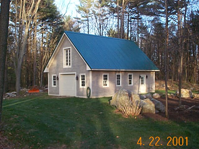

I agree with Will C I used the Wayne Dalton brand too, R10 insulation with steel on both sides, low overhead type doors for my shop/barn and the garage too. I had Seacoast OH Door from Rochester NH put them in. He is owner/installer and is competitive.
My doors are 9'Wx8'H Low Overhead - means you can have 6" clearance between joists and door frame. Since I have 8'6" interior ht and needed 91" for the B21 that worked great.
Cost for the two doors installed $1250 - no openers tho. You can go to HD and get std door sizes for less 8Wx7H..
Carl

Mark,
The OH door tracks install inside the trim on the 2x studs so if you have 7'Wx7'6"H between studs and joists a 7x7 door would work tho you will have 3" of door inside the bldg and the left and right panels will be smaller. The trim flaps then get installed on the trim pieces to seal the sides and top.
Most std garage doors are 8'Wx7'H.It's probably cheaper to modify the opening than to have a custom door made.
Good Luck
Carl

Carl, I love that barn!!
   / Overhead garage door tips #10
Will,
Thanks for the reply. We had many active discussions regarding windows, etc that needed to MATCH the house, detached garage & office.. Added $$$ to the total project but now that it's done and paid for I appreciate the detail and match to the other two bldgs. I'm not the decorator just the designer/digger/workerbee..
It's 24/36 with floor trusses - no posts with a 12/12 pitch nice area upstairs as well.
Carl
