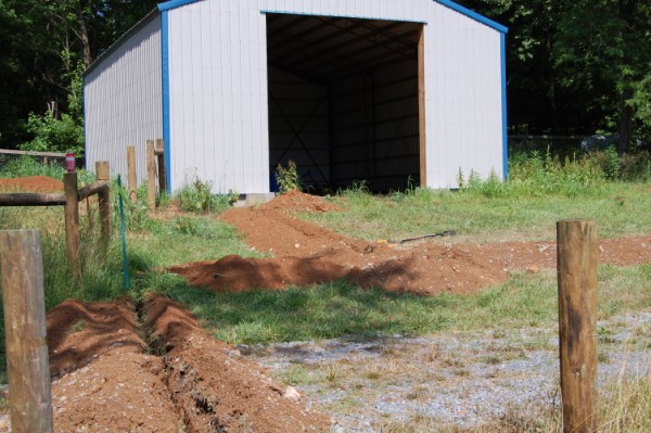

Anyone know any companies that provide overhead garage door kits. I'm trying to find a company that if I provide the measurements of the opening that they can provide all the hardware for the garage door. Opening is approx 15x15, and I'm thinking of an overhead door due to simplicity. I has hopening to find something where the garage door is in panel sections that is then bolted together during assembly.
Looking for something no frills of design and asthetics.

i bought a door for mine like the ones on the storage units,a 10 x8 was 230.00try your local door company thats where i got mine
   / Overhead Garage Door #3
Try this company: Overhead Door Dealer Locator
I have their doors in my shop and really like them. They are more expensive than "barrel" or roll-up doors, but you don't have the issues with the barrel not wanting to unroll and come down. I think I posted a link for you local dealer.
