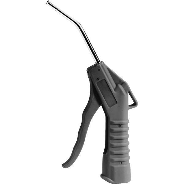

Tractor Supply does not have the 2' long one on their website, but it doesn't mean you can't one there. They do have one like shown in the attached pic. It might work better than the typical blow nozzle, but not as well as the 2' one would.
edit.........
Northern Tool has both the extendable one and the fixed 2' one. AND there are 7 retail stores in NC. None in Ohio yet /forums/images/graemlins/crazy.gif
