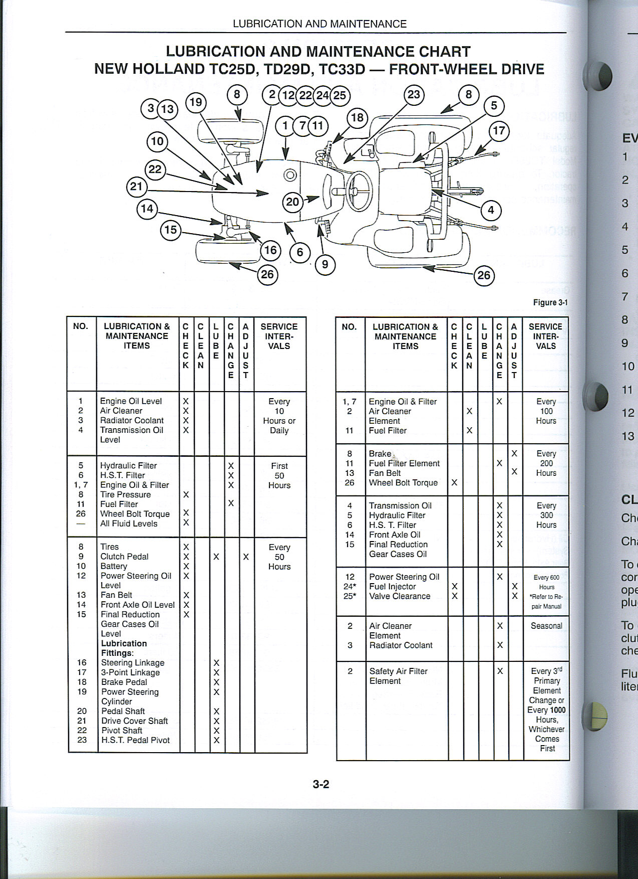

I took delivery of 2002 TC40DA SS several months ago. I bought the lincoln rechargable grease gun and hit the loader zerks every time out and the others I can see often enough I think. I did not get a manual with it and wondered if I'm missing zerks underneath that I'm not aware of. I can easily get under tractor on concrete floor of new storage building if I know what I'm searching for. Any help would be appreciated.

If you PM your email, I'll send you a PDF of the manual I downloaded from here some months ago. Not sure if it is still available.
There are 12 SS zerks that require grease every 50 hours, and if you have the skid steer system, your loader should have 14 (can't remember the loader # for certain now...but SS is definitely 12).

On my DX29, there are about half a dozen zerks more or less under the operators platform for the various pedals and shafts. Some of them are pretty inconspicuous unless you know where to look.
   / OVERLOOKED ZERKS!!! #7
I guess something to think about is if it rotates, flexes, pivots, there is probably a zerk nearby to keep it that way.

These are what the manual lists for lube points on the tc33d. Hope this helps.
