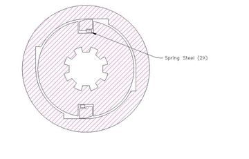

The outer part of the overrunning pto coupler will not turn for me to line up the holes to remove the pin. It appears from marks on the end of the coupler that a mechanic that worked on it hit the end of the coupler to drive it on after he had removed it. Do you think this could have damaged it and could you give me ideas as to what the damage might be?
Can someone please tell me what the inside of the coupler looks like and is there a way to remove it? Does anyone know where there is a diagram of the inside of one to help me plan how I can remove it?

There is usually just a ratchet pawl inside that is spring loaded and only lets rotation go in 1 direction. A picture may help? Ken Sweet

originally, unless a qd type, a roll pin attached the inner piece to the shaft and left clearance for the outter to spin
on most I see, there is a specialized clip like an e or c / circlip holding the internals together.
here's a basic diagram of the operation.
