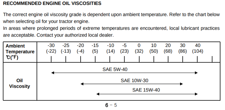

Your turbo diesel engine will do fine on 15W-40 in your climate. If you're concerned, send a sample to Blackstone Labs for analysis. Ask for a particle count as well to verify your filter is doing well.

I would only use 100% synthetic oil in a turbo. Reason being the coking effect after shut down when hot. This can be eliminated by idling the tractor for a few minutes after using it. I let my tractor warm up until the heater is throwing heat and idle for at least 5 minutes after using it. I live in Maine and use my tractor with snow blower for almost every storm. I have a Kubota Gr L6060 turbo. I use Rotella T6 15W40 full synthetic. I have my tractor in a heated building 40 degrees. I know a lot of guys that run the Rotella T6 5W40 and I would also if my tractor was outside in the cold. If I was in your climate I would use 15W40 full synthetic let the tractor warm up before any hard use and always a cool down after.

That 15w40 oil will leave your top end starving for oil in cold starts this time of year for a few seconds.

I got one I like to start in cold weather on occasion. I dont "have to" and dont but. It was made in 68 and was one of their lastest engines to call for straight weight and we added an MW turbo but it didint like multi at all, lost hot oil pressure on them. It wasnt till well north of 2000 or so that 15/40 held up. It was a problem if a guy wanted to use it in the winter and maybe it was or wasnt such a deal and we thought it was but it really starts better on T6 5/40 and runs well hot. I use it in my Kohler mower and conventional in most everything else.
