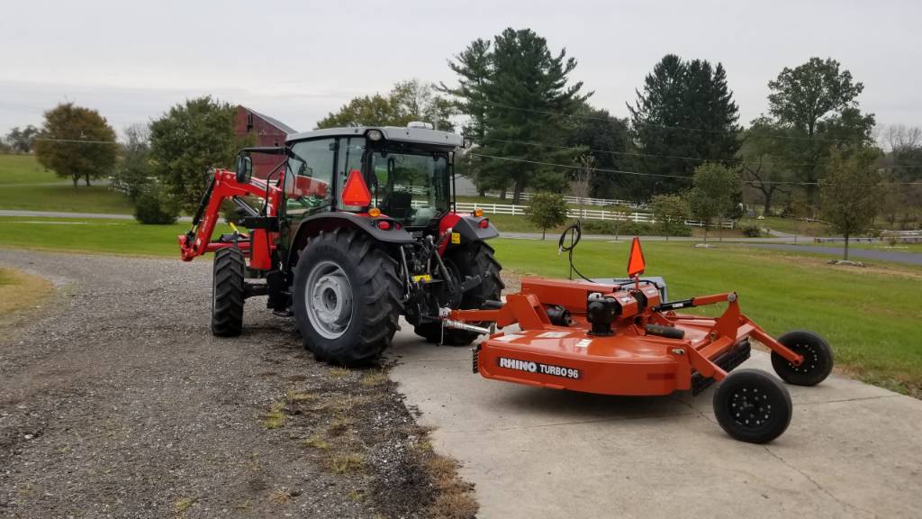

   / Owner /operator #5
Love my Turbo 96 also. May want to check you blade synchronization 20181026_120043.jpeg
