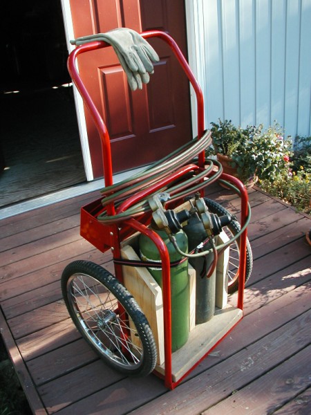

Rgillard, I bought one of these from harbor freight and it has worked out well for me... I'll post a pic of the finished product when I get home(hopefully I won't forget!!)
I am using the smaller bottles so I made a wooden insert to take up the extra space and divide the bottles from each other.

OK finally got the pics of the bottles in the cart.

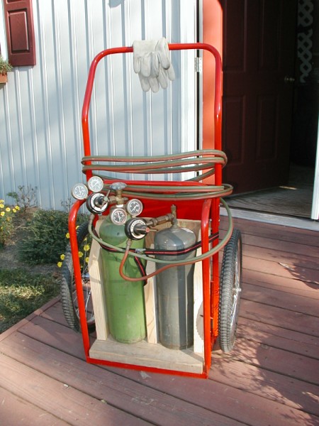

The back is 3/4" plywood the bottom is 2x10 and the dividers are 2x8 pretty sure about those measurements... Holds bottles nice and snug.
Oh and the little tray in the back holds the striker and the torch and extra tips. the tray swings with the angle of the dangle /forums/images/graemlins/cool.gif
