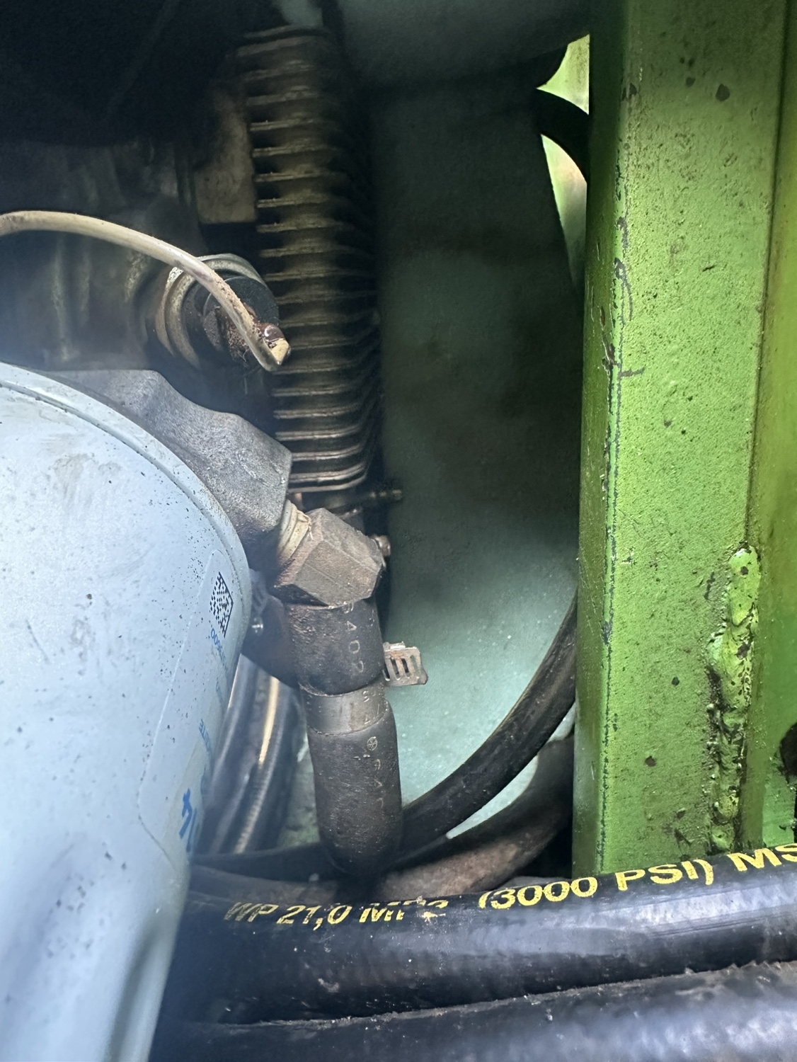

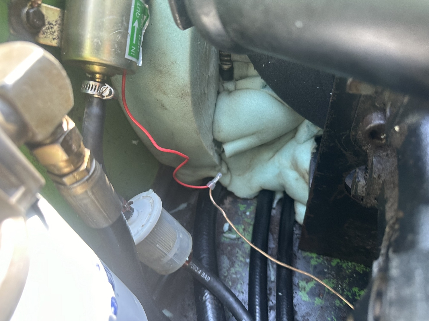

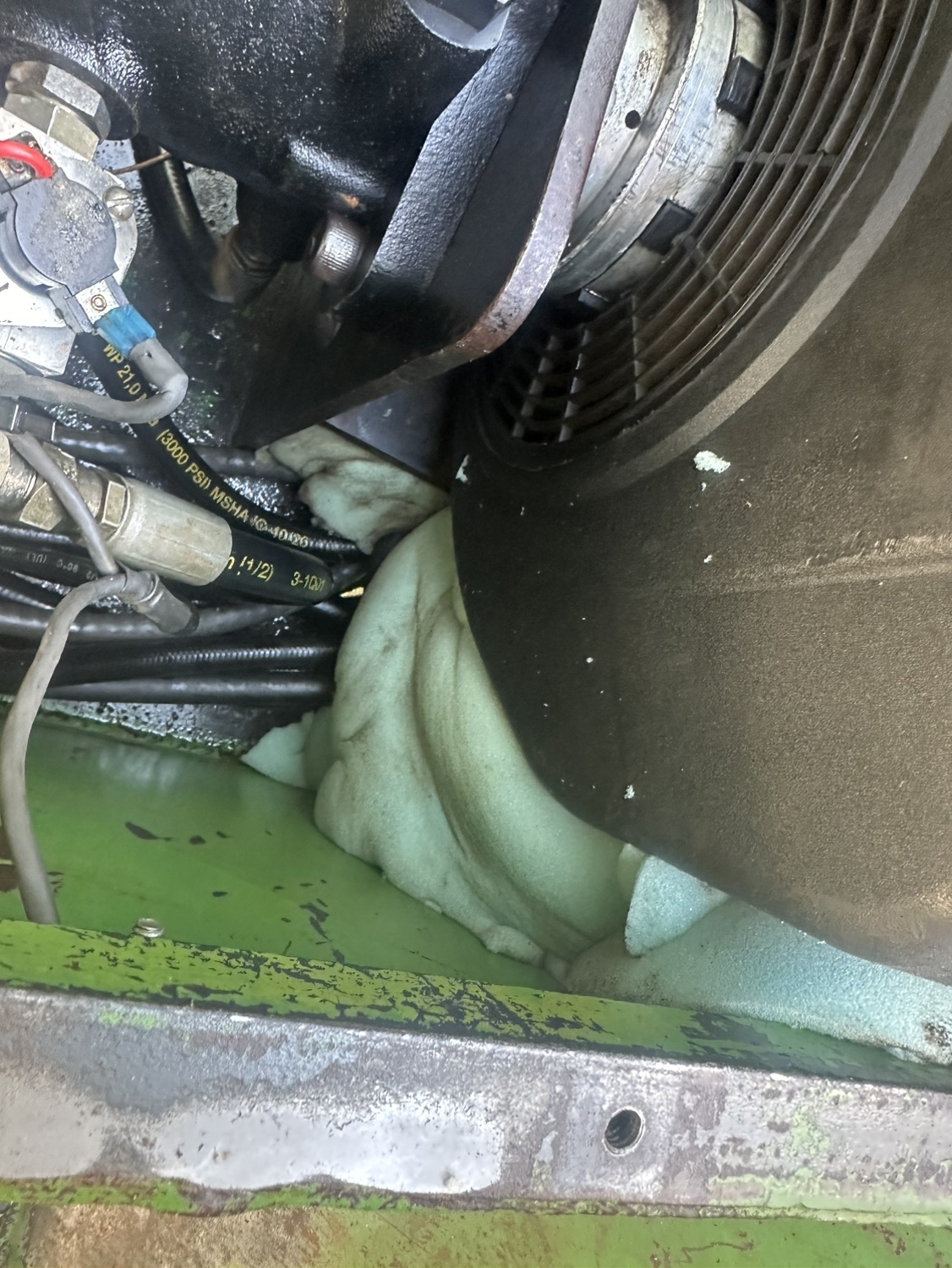

For some reason, my pics will not come up on the other post that I sent it in so I’m actually sending this out so you can see the pictures
In the first pic notice that i blocked off the area that is under the engine mount plate as well.

It is regular foam i bought at Walmart. Been ising it for a year now and no issues, at first i was worried about it coming out of the spots but it stays put. As far as ignition or flamability resistant , not sure. But it eradicated my cooling and vapor lock issues.
I know that some people may have issues with the foam padding but i wanted to put the idea out there for a solution to someone elses problem.
   / Padding to help cooling #4
Roger that, it is proof of concept. It proves there are benefits to separating the cold air intake from the hot air discharge.
