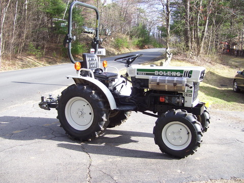

Hi, I used Ford Grey for the white body panels, and I used gloss black for the rest. I bought my paint at Tractor Supply, but I am not sure where you live. This is the link to the thread about restoring my G154: http://www.tractorbynet.com/forums/iseki/239234-g154-restoration.html The air filter link is listed below, and the hydraulic oil can be regular multipurpose hydraulic fluid. It takes 13.7 liters, and I originally had used 80w 90 hydraulic fluid, and that worked fine, but the last fluid change, I used multipurpose tractor hydraulic fluid. For the engine oil, I used Rotella T 15w40. Below are also some photos of my tractor, after I painted it. I was able to match the colors to the original colors, or pretty close. Hope this helps a bit. There are a few programs available depending on what area you live in as well, like the one I used to purchase my ROPS. Hope this helps a bit.
