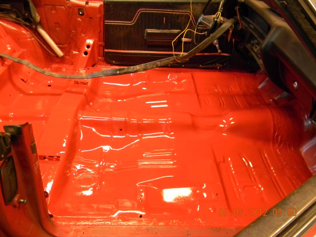

I sprayed Rustoleum paint on a new one piece floor pan I installed in a Chevelle convertible last year. I used a cheapy Harbor Freight HVLP gun, compressor air pressure set about 40#, (drops to about 30-35 pulling the trigger), 1.4mm, I thinned the paint roughly 2 to 1, (2 parts paint to 1 part mineral spirits). I did not use hardener just a day with a box fan blowing on it to dry. Rustoleum red for the top, when dry I put the car on the lift and sprayed rustoleum black underneath. It should work the same on your trailer. I've sprayed rustoleum on many projects, just happened to have a pic of this one. I did my car trailer in black using this mixture also but brushed it on rather than spraying.
