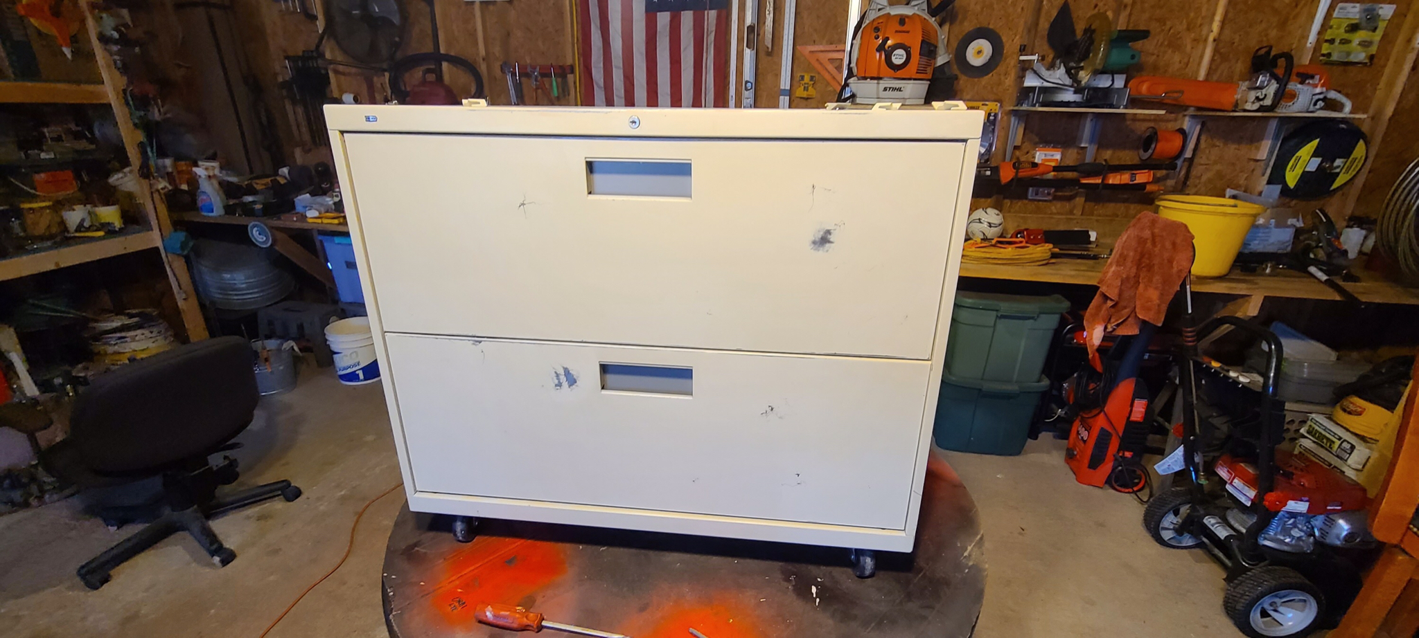

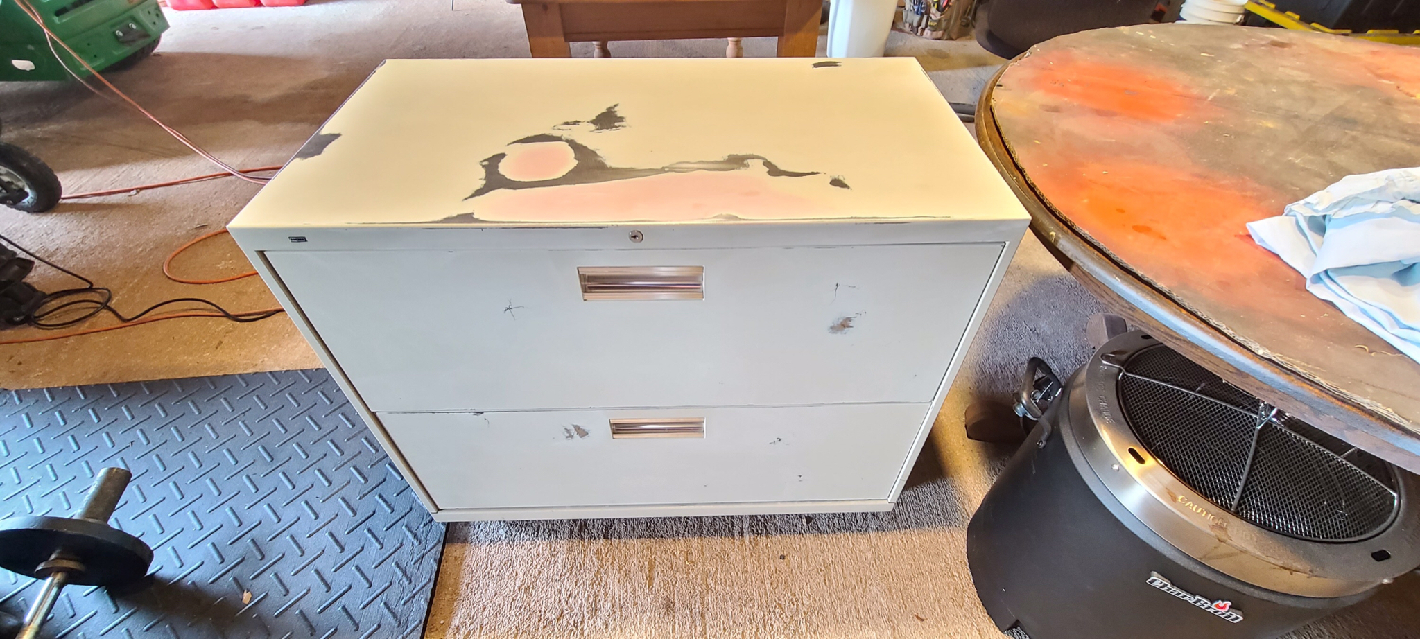

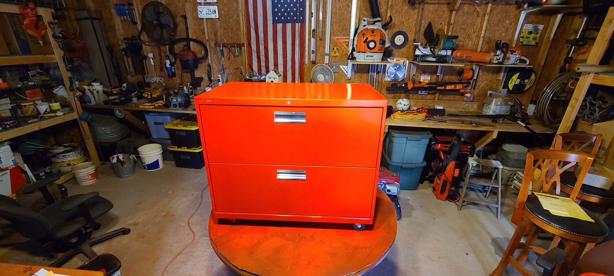

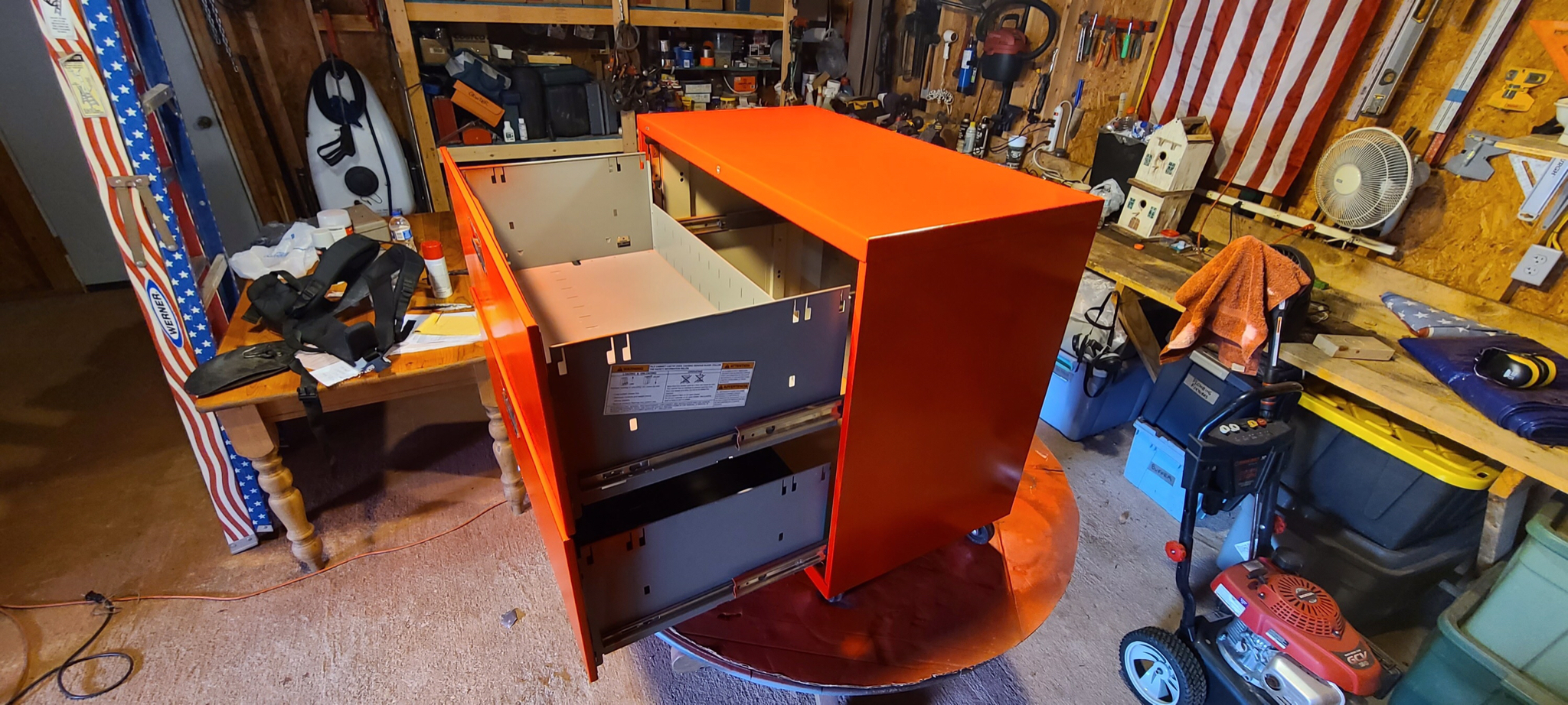

I need somewhere to store tools that don’t have a case so that I can free up some shelf space. I have one more of these file cabinets in the house that I may do this to, if needed.
I defeated the safety mechanisms so both drawers will open at the same time and all the way. I purchased a furniture dolly for $8 from Harbor Freight just for the casters.
I did some bondo work on some minor dents. This is good practice for some different exterior electrical boxes on the house and for the pool that need paint really bad.
Next up is rebuilding the workbench you can see in the background. Currently it has rough cut lumber for the top and it’s terribly uneven and whenever I use the grinder it all falls through cracks onto everything stored under. I want to put plywood.

Looks great. I like the price, too :thumbsup:

Defeating the drawer interlocks and adding casters could make it very likely to tip over when the drawers are opened with heavy tools in them. Do you have some other way of keeping it upright when the drawers are opened?

Maybe relegate its use to lighter stuff or hang heavier tools of back side on hooks as a counter weight?

You could put it under a workbench so that it cannot tip forward.

I have a cabinet that was prone to tip-overs. I didn't need it to be mobile so I bolted it to the wall.

Yes lateral files are notoriously tippy. At the office we'd either attach them to the wall with a strap or fill the bottom drawer first.

That’s a good thought but it really isn’t tall enough for me. I do have 2 tables and a 24’ workbench that will be more user friendly once I replace the top.
I’m thinking tipping won’t be an issue but if it is I planned on strapping a steel plate on the rear.

Neither one tips with a single loaded drawer fully opened.
Never found need to have 2 drawers opened at the same time.
