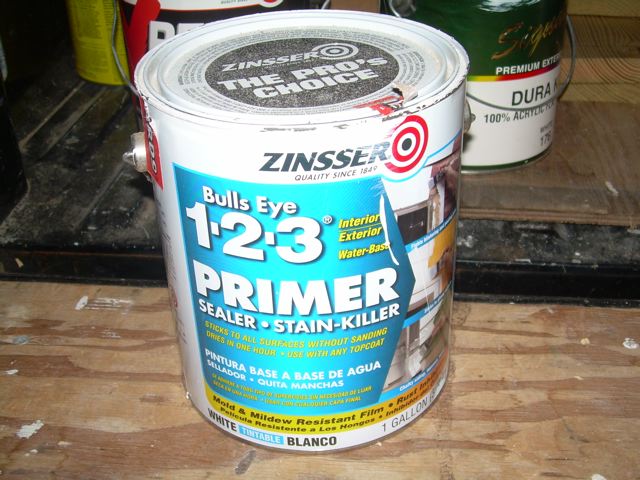

   / Painting paneling #4
I would wash it with TSP (tri-sodium phosphate), buy it in powder form, mix it with hot water and wash it with a sponge, very inexpensive and effective and easy on your lungs - careful of the sovent-based deglossers. Wear gloves :rolleyes: . Then prime it, I like Zinsser as well, try their BIN 123 water based primer, it should do the trick. Fill the nail holes and paint away :)
EDIT: make that Zinser Bullseye 123; Zinser BIN is the best and will stick to anything but is alcohol/shellac-based and you would need to wear a respirator.
