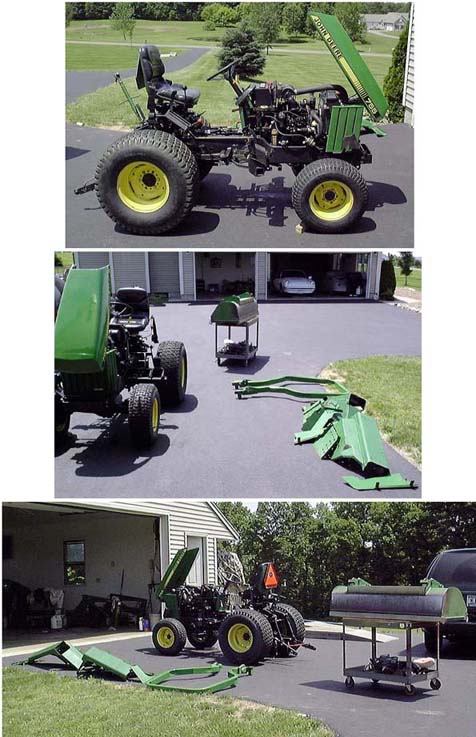

Here are some photos of my neighbor's JD 755 that we painted last summer at my place. Looks like new when we got done!

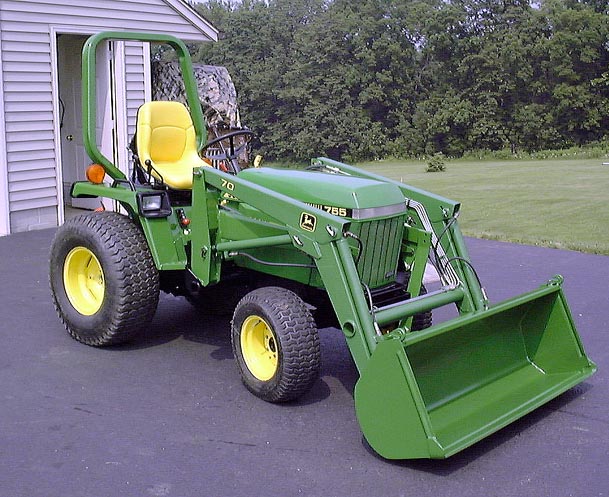

   / Painting your tractor #6
And here it is done!

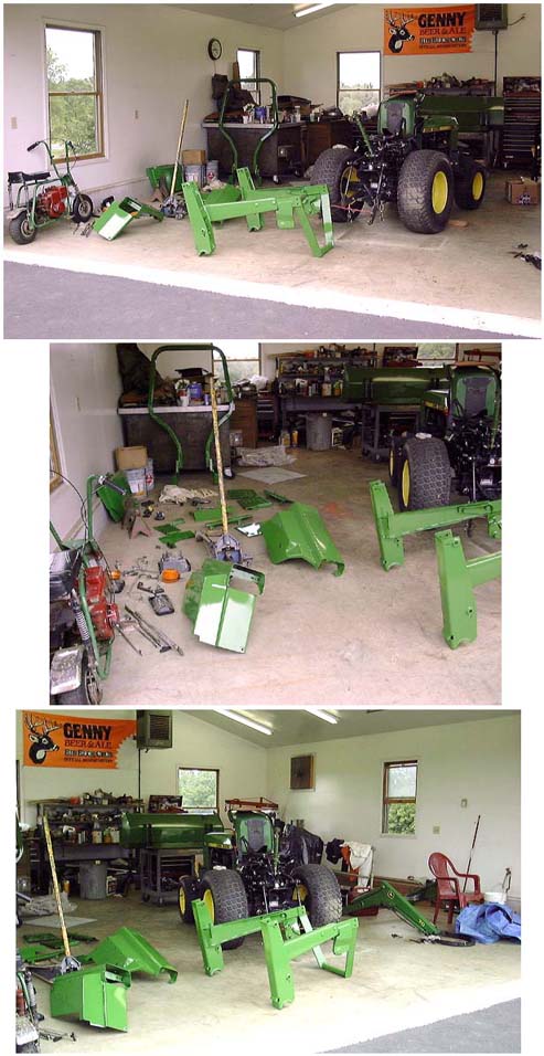

   / Painting your tractor #7
And here it is all back together!
   / Painting your tractor #8
You can't trick me... I know a new tractor when I see it! /forums/images/graemlins/grin.gif
Wow, what a nice job.

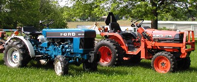

It took a bit longer to get good enough weather for mowing. Here's a pic. Both tractors could use a wash job..............chim
