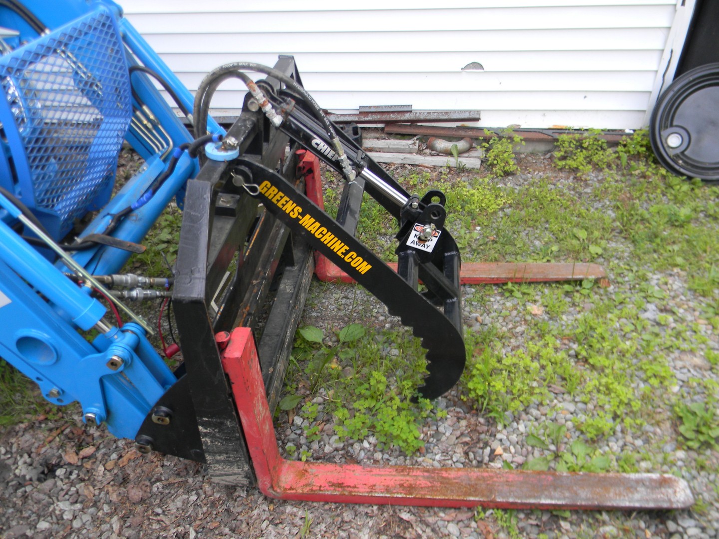

I'm sure some people have used clamp on forks for that purpose. IMO the clamp-ons will put a lot of stress on the lower lip (cutting edge) of the bucket plus 1500 lbs may not be HD enough to lift a tree depending on diameter and type. Would probably be OK for shorter sections you cut up though.
A friend of mine has Titan clamp-ons and bent his cutting edge and one of the forks lifting a too heavy tree.
Not sure what clamp-ons cost but my QA skid steer forks only cost $500 and I added a thumb to grab the tree.

Save up a little more money and buy quick attach pallet forks. They are outstanding and easy to use. Pay once cry once.

X2 for getting regular forks especially if you already have the SSQA, keep an eye on Craigslist and I bet you can find some used ones close by.

I've been using Titan clamp on's for years, no bucket damage but I don't try to max them out. They go on and off in a minute and cost me about $150. Adding SSQA will cost me about $600 JUST for the SSQA. Plus they store easy. So I paid about 1/10 of SSQA plus forks. Have not cried yet.

Quick attach forks are really easy to attach. I haven't tried the clamp on type but those probably involve some manual lifting to get them on the bucket. With QA implements you just drive up to them, pick them up with the loader then flip the locking levers.
They will take more space in the barn though. Some people who have made dollies for implements have made one so they hold the pallet forks and another implement like a box blade, with the forks' tines under the box blade. So two implements fit in the floor space of one.
Unlike complicated expensive implements like PTO chippers you can leave the forks outside. They'll rust a little more, that's about it.
The Titan pallet forks are about $500 including shipping. Mine fit perfectly.
