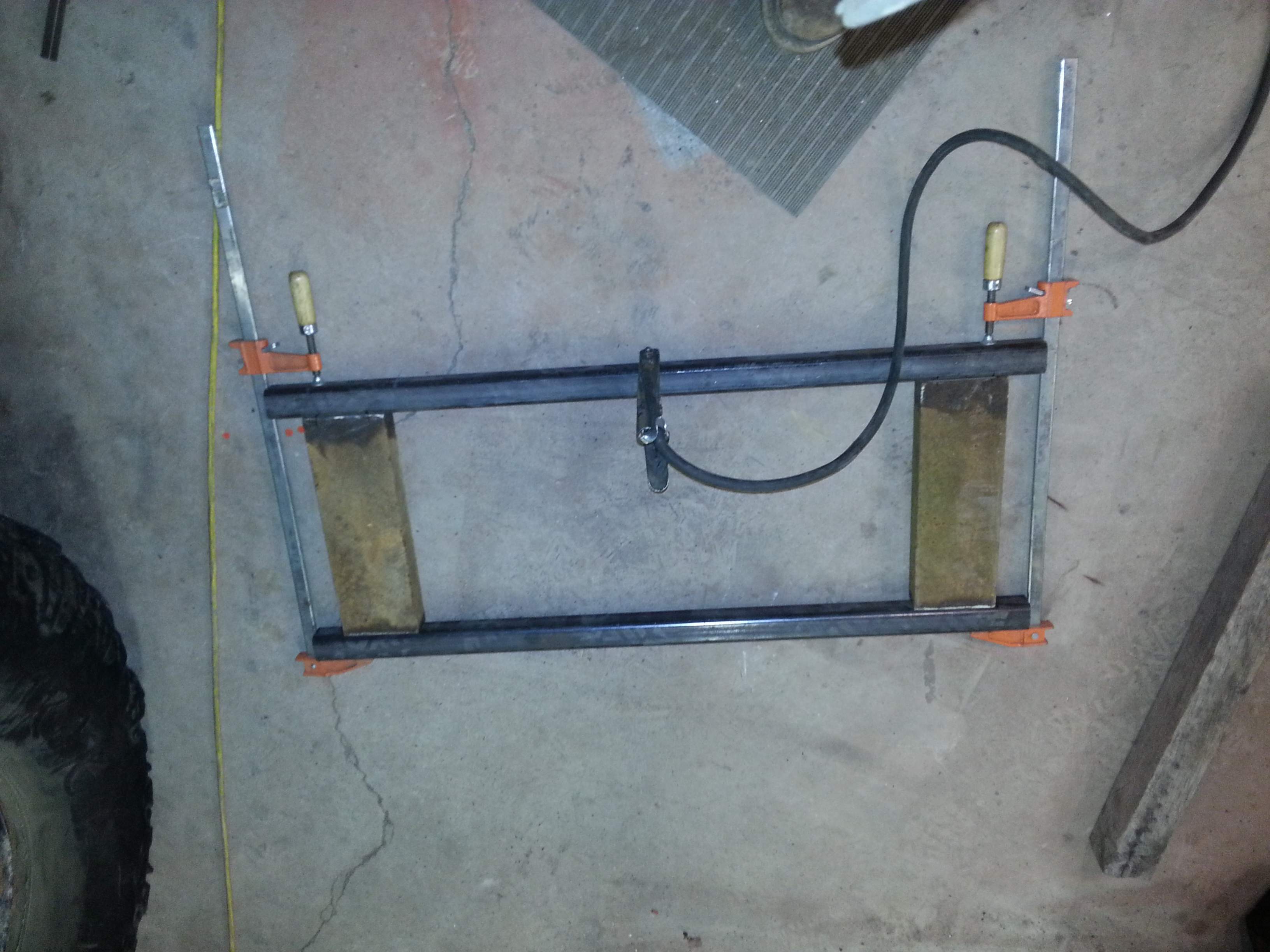

Well I moved my nissan forklift down to the farm so we could use it to load stuff in the barn. I didn't want to bring it back to my house for the basic stuff I do here in town so I decided it was time to add some forks to the FEL. I had some spare 36" forks in the scrap file @ the farm so I decided to bring them up for the build. I had all the material on hand to build this from other projects. I just had to buy some 1" pins to leave in the frame for the QA.
First was building a frame and I had some 1.5"x.25" Wall Square along with some 4" channel. Cut them and welded them together.

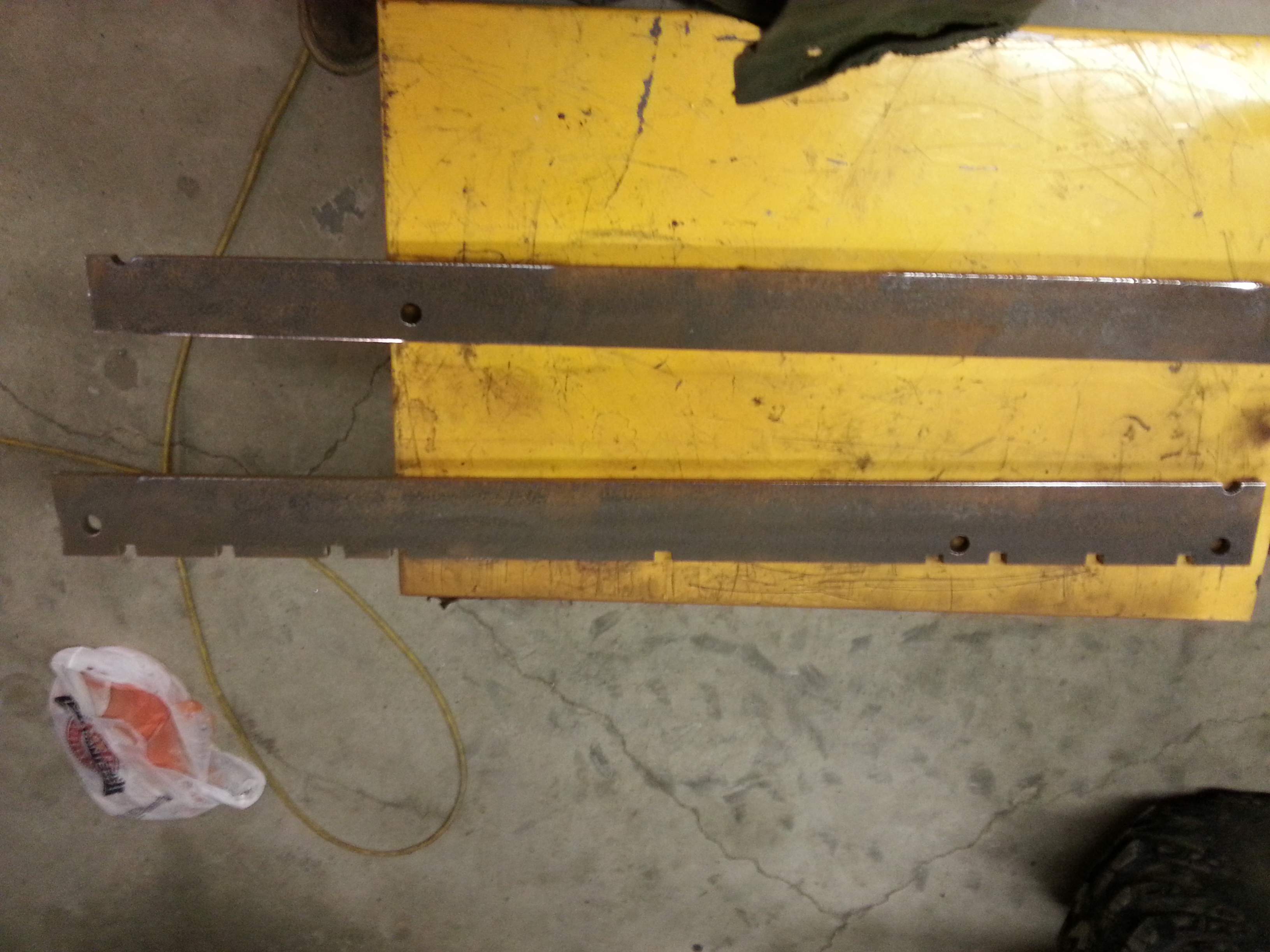

Then I found a nice piece of 3/8" plate to hold the forks. It was about 5" wide. I put it in the mill and milled out several detents for the pallet forks to grab into with the pin.
After that I ripped the 5"x3/8" plate in half long ways for the top and bottom. The top has the detents.
I then measured about 20 times trying to get them close to 16" apart so the forks would slide on. (I will probably run a grinder across them a few times because the fit is snug now).
