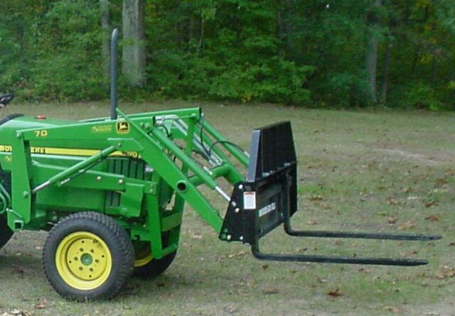

I'm working a deal to get a Kioti DK45 with KL2049 FEL. I'd also like to get pallet forks to off load 1 ton pallets (horse supplies & such) too. I don't think I need the quick attach plate, so is there a pallet fork available to replace my bucket?

Picture is of a Woods small loader pallet forks model 20A on a JD 790 tractor
For more infor see PHOTO forum titled "Testing New Pallet Forks.

Does this pallet fork attach by removing four pins to the bucket or does it use some other means?
   / Pallet Forks for Rhino 2049 #5
I have a standard hook up, the pallet fork go on just like the loader bucket, using four pins....
The brackets are adjustable for different widths an come drilled for different pin sizes...
I've found far more use for the pallet forks then the bucket.

i have a DK 50 with FEL . i atatch forks at times and there i no way i could lift 1 ton. Once more the FEL is not rated to do so i think off my head about 500kg is all.
