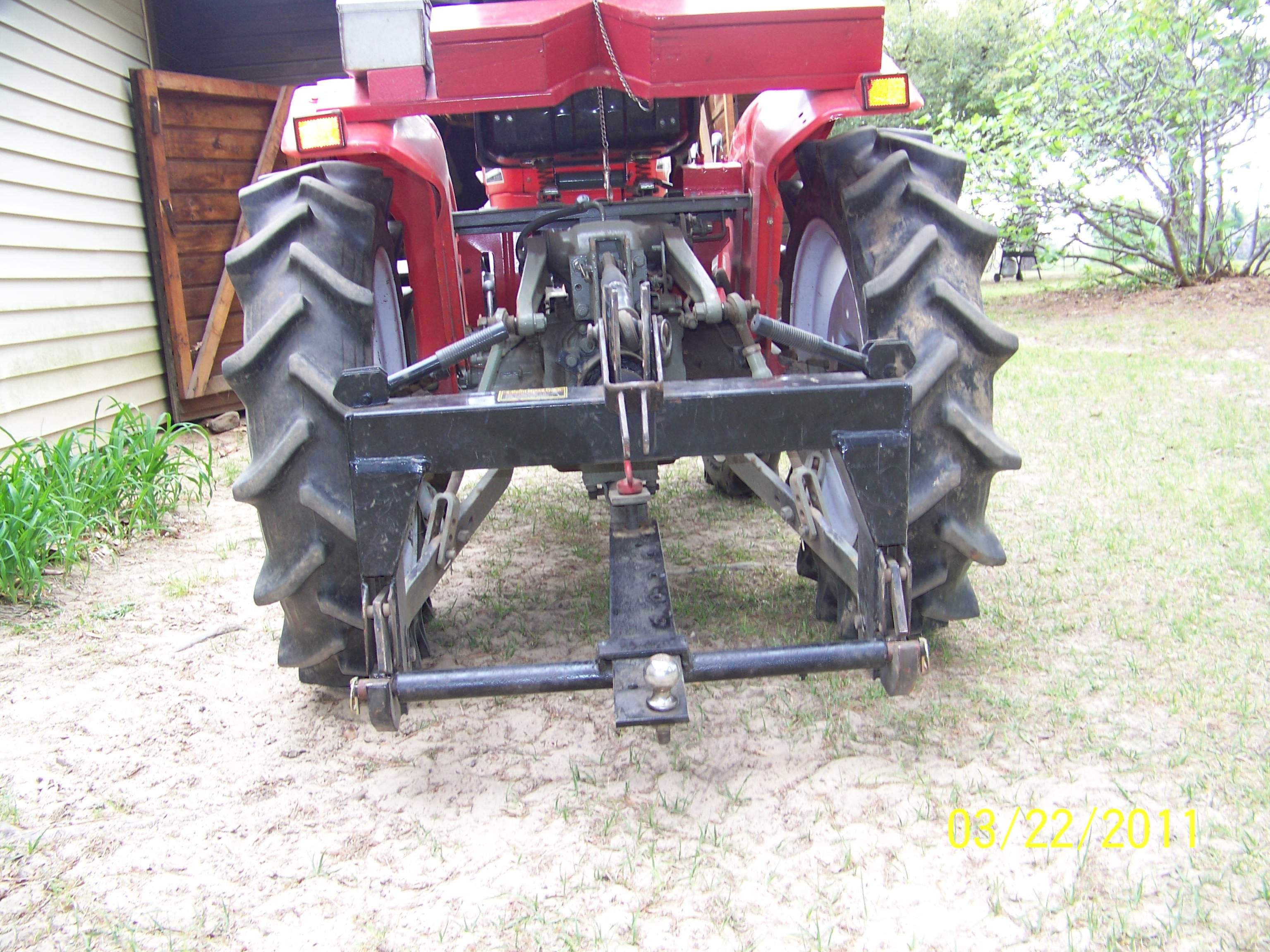

I picked up a used quick hitch, but am missing something on the top (No hook? Do I need the Harbor Freight yoke thing?) So haven't even got it mounted yet.

Back to the hitch -- I notice there is no part number in the manual. Mmm. Will take it in when I get there. Somebody -- California? Has some good pictures of his implements with the quick hitch one quick hitch threads.

Don't guess it will do you any good but here is a picture of my Harbor Freight quick hitch with home made adapter.

The QH top adapter part# isn't published. Phone HF customer service to order. Should be under $20 including shipping.
I don't know if you can get a replacement top hook too, but HF is pretty good about providing replacement parts. If you need to have a hook made locally, space the hook back farther from where it bolts on. With HF's design some implements jam against the QH chassis before the hook is fully engaged.
