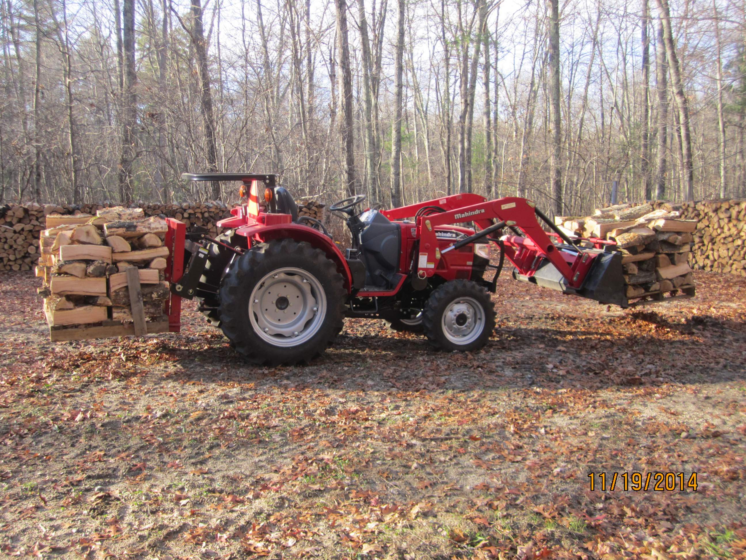

I have a Mahindra max 28 and am debating what to do. My brother gave me a set of forklift forks to use on my tractor (forks only). This series of tractor does not have a (quick attach system). So here is my dilemma
FEL has a lift of { 1402 lbs @ pivot pins } according to the brochure.
3pt has a lift of { 2205 lbs @ ? } according to the brochure. It didn't specify if at the ends of the arms.......
I can make a quick attach for the loader to install the forks or utilize the 3pt for its lifting capacity. It would certainly be used if placed on either end of the tractor but which end- to get the most lift would make the most sense. I will not be placing heavy things high on shelves and have a great loading dock, "hill/bank for loading 4 wheeler lawnmower into bed of truck". I would like to transport palletized wood/engines and other heavy things more easily though. Perhaps there is someone who has used both variations could give some insight on the use of their forks.
Also, does someone have the formula to calculate the 2205 to the bar ends? Maybe that is the quoted weight limit at the ends? I am unsure.
I am certain that any load I move would be safer at the rear of the tractor, we all tend to push the limits of them from time to time. Here is the Pdf that I got the info from.

To answer your questions, naturally the loader will be able to raise the forks much higher than the 3 pt. but the 3 pt. will be able to handle more weight. With a little work by replacing the loader bolts with the same size pull pins (mine were 1" dia. on a 2615HST) you could obtain a quick attach adapter to use with other quick attach implements. If you do mount the forks up front you will need counterweight on the rear. I believe the 2205 is the 3 pt. lift at 24" back (which would be the ends of the lift arms). That's what my 2615 would lift also.

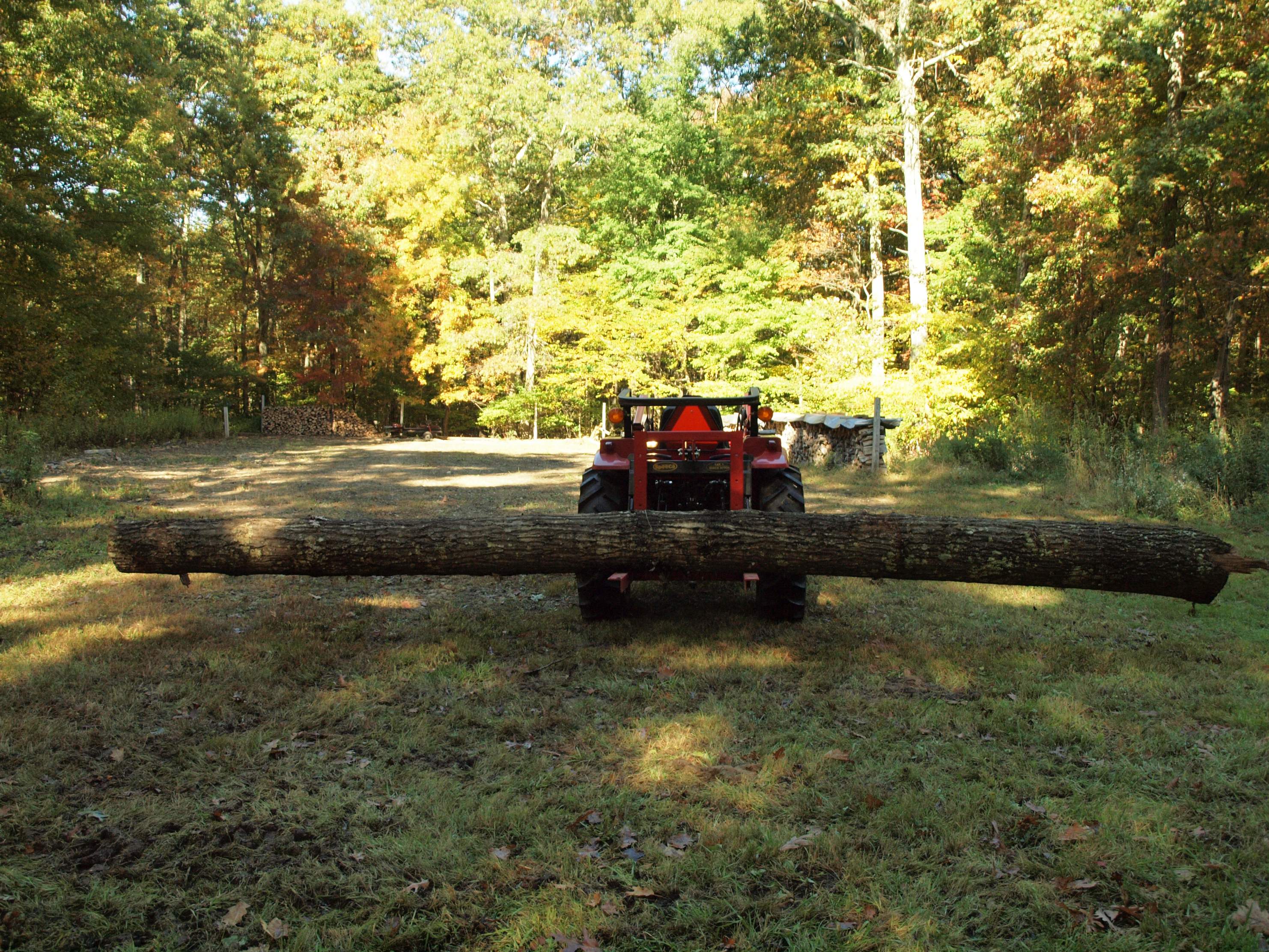

arrow----- that pic you posted looks to be much safer in the back than the front. Does it make your front end light, This is certainly an option that I am considering

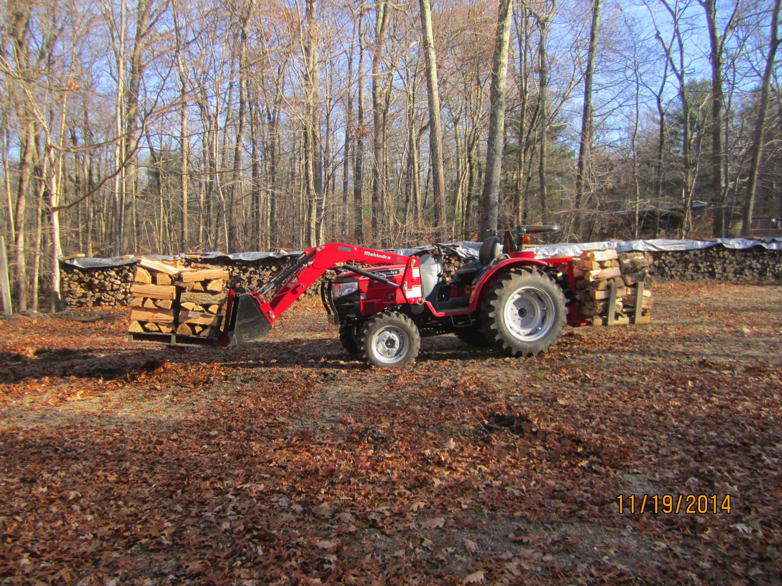

Not at all or I should say none that I noticed.
I had to move some wood this aft and I added a picture of such to my first post above. This is what I meant by utilizing both ends at once to take advantage of ballast and efficiency. This is another shot from the other side. Cannot see much detail from either but it should get the point across about weight distribution.
If you double click on the photo, it may blow it up some.

You wont loose much lift capacity going further back on the 3ph. Its a parallelogram style lift. I'd say you should have no issues lifting and moving 1800-2000lb pallets as long as you can keep the front wheels down.
So the issue there becomes the hydraulics can lift more than I would be comfortable with on that tractor.
The loader, maybe half that amount.
Why not make it to be able to be used on both front and rear. shouldnt be that hard
