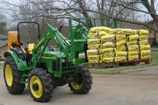

Okay. Here was the first big test. There are 36 bags of ready mix cement for a fencing project. The bags are 80lb each so I’m lifting 2880 pounds plus the weight of the pallet forks themselves. I haven’t weighed the pallet fork assembly, but I’d say it’s in the 500 pound range. This puts the load right at the maximum rated capability of my FEL which is 3300 pounds breakout. The back tires were a little light. I lowered the load to a foot off the ground, stayed on level dirt and made my delivery to the new fence line without feeling too unstable.

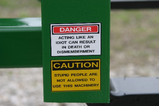

In case you were wondering what the DANGER and WARNING stickers were all about. This is a spoof aimed at the all the legal verbiage you see on tractors and machinery these days. I had them specially made and you will find these same labels on pretty much all my work. Funny thing is, they look so official, most people don’t even bother to read them.
