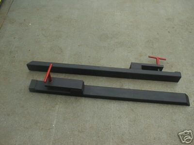

I bought a new JD 4310 with a 430 FEL; awaiting delivery. I think I need some pallet forks but I think I want to take off my bucket when I use my forks. Does anyone have any recommendations? I want to use the forks for helping clean up 11 acres with a lot of downed trees and brush and use it to move (not necessarily stack) smaller round hay bales.

I purchased forks for my B21TLB with the HD bucket (required spacer under bucket due to cutting edge) on ebay from Dave Mattox $275 included shipping. They are HD 36" clamp on type and great for logs, wood, brush, just load and go. I have handled 900-1000LB root balls when planting this summer - just need to make sure you get near the bucket or no lift.
After I bought these I saw another design with a piece of bar stock to keep pressure on the lip of the bucket - this is better IMO.
If you are buying new consider buying the ATI removable bucket and forks attachment, this is a better set up if you are using the tracor for mowing and is fast. My cousin has this setup on his 7810 Kubota. This is about $6-700 more if I recall.
I have attached web page for the forks with the round bar stock and also web page the ones I purchased from Dave Mattox. he can be reached at dtmattox@charter.net.

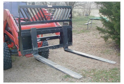

I have a set of Piranha HD forks see pic. These are 48". watch Ebay like current item 3838507850. Around $400 to 500. will get you a set that will handle anything you are apt to do with them. I think I have spotted others like Markhamwelding that look very good also.
