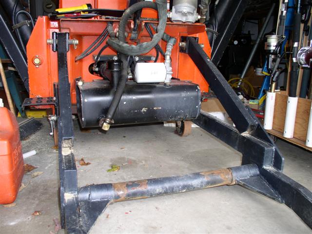

I built a dolley for my Woods BH (1600 lb). I used 2 pieces of 2x2x1/4" angle and a 2x2x3/16" sq tube across the front. Sounds flimsy doesn't it. It's lasted for 5 years and I've even towed it to the street with my truck with the BH on it. The secret? Don't put any forces on the frame members. All the frame does is hold the 3 casters in position and the load is place directly over the casters.
Here is a CAD print w/dimensions and a couple of pics. I'll be glad to make any mods to the design you would like. The back of the bucket wedges in the vee of the frame and I just lower in on with the stabilizers and unhook the pump and roll it away. My subframe comes off for winter outside storage so I don't trip over the darn thing.
The first pic is just the subframe and a glimpse of the dolly wheels for info. See the PDF for full plans.
  • backhoe dolley.pdf
