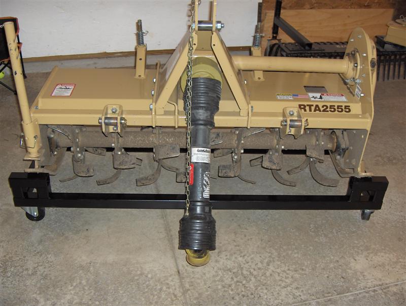

I have made dollies for my tiller and box blade. I used 3" rubber wheels for the tiller and 2 1/2" steel wheels for the box blade. The larger dia rubber wheels do roll smoother. If i had to do over i would have used 3" rubber wheels for the box blade.
