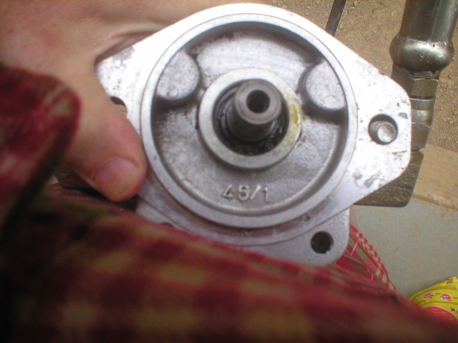

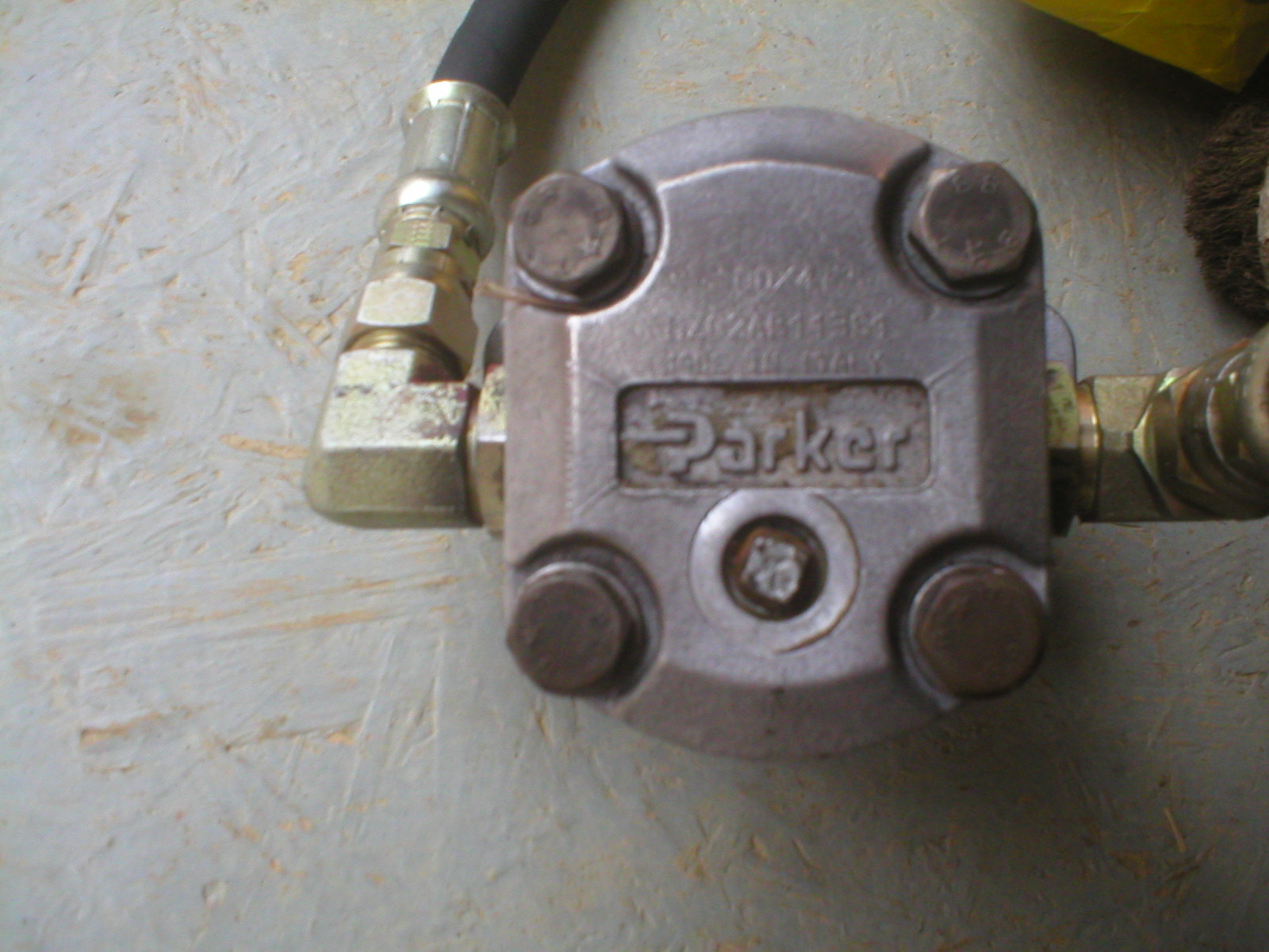

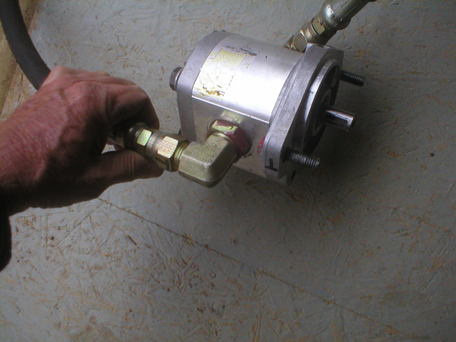

I need help trying to find information on a Parker hydraulic motor(parts listing) and specifications, pictures, etc. I could not find it on Parkers web site. The information on the motor is Parker , 00/4, MZG2AB113S1, Made in Italy. See picture attached. Found that it was last made before 2002.

Is there any way to figure the power, rpm's a hydraulic motor is producing?
   / Parker Hydraulic motor #3
MZG2AB113S1 the model number itself should give details of all the specs for the motor. design style and like. but honestly don't know much beyond that.
best suggestion (i hate parker website) is to find the "dealer locator" or contact parker directly through email or live chat.
they have way to many models based on exact same specifications, but say a outlet is 1/4" smaller than outlet or vice vs, or different mounting hole options. exact same motor just different options. and in that regards, i doubt you will find the exact model with detail info on it. but rather a general spec's for overall model. and reason for trying to point ya to a dealer or contacting them directly. so they can look up on there computer info, and give it to ya or like.
   / Parker Hydraulic motor #4
You should be able to figure the approx displacement by pumping a known amount of oil from one container to another by manually turning the shaft and counting the revolutions. Once you know the displacement you can figure everything else unless it's badly worn.
   / Parker Hydraulic motor #5
MZG2AB113S1 HYD MOTOR
Manufacturer = Parker
Gear motor
Shaft rotation = both
Pump cu in = 11.3
Port thread = SAE straight thread
Shaft = keyed.
