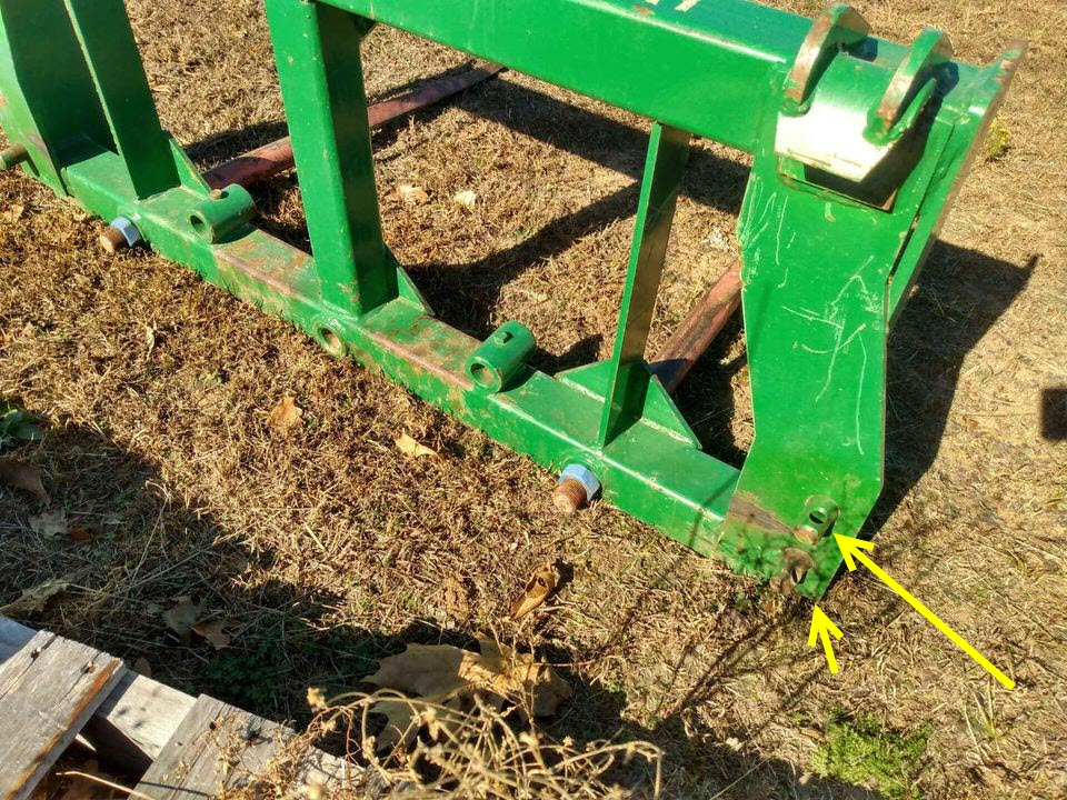

Hi all,
I just picked up a used Titan John Deere quick attach style hay fork.
It is missing one of the pins on the lower part for the JD quick attach.
Yellow arrows in picture show the item I need.
Anyone have any idea where to get these? I can see that they are welded on so should be pretty straight forward to replace.
I have sent a message to Titan so we'll see if I get an answer.
Thanks for any ideas.

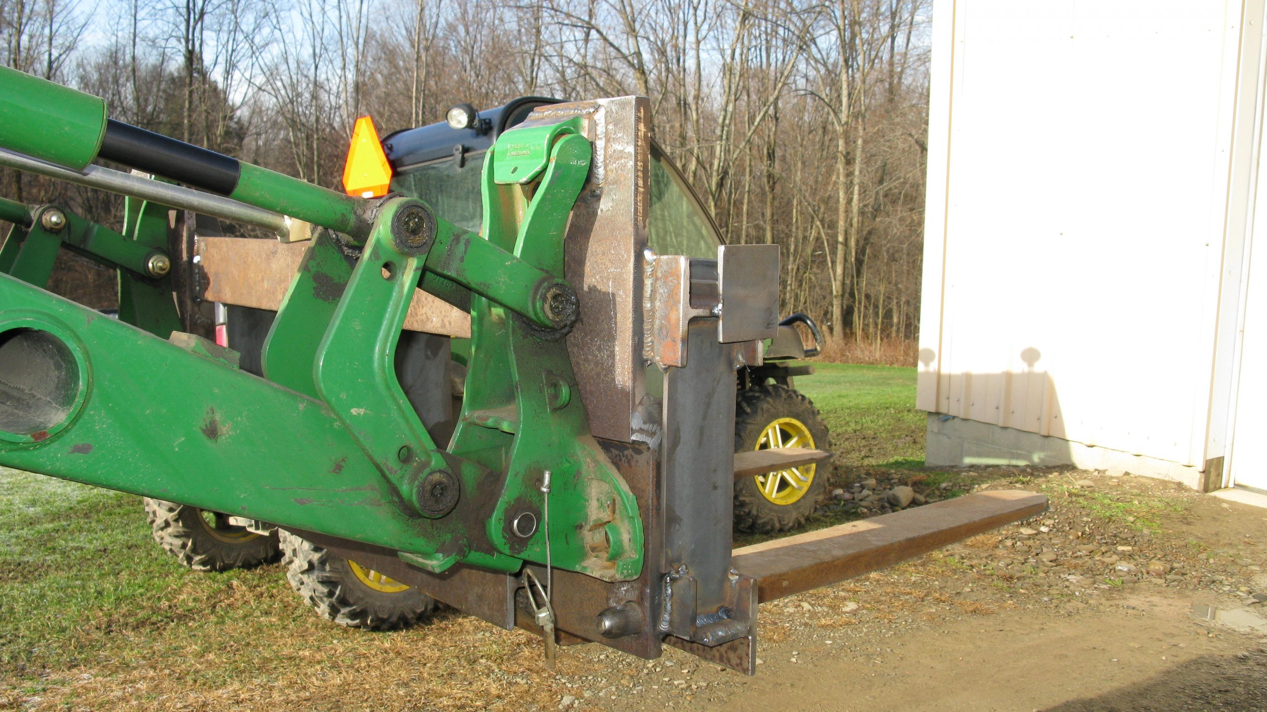

I have purchased the pins and the upper mount directly from our local John Deere store/ LandPro. The upper mount and pin arrangement is the John Deere style of mounting. The lower pin is used for the larger 5000 series loaders with I think it has a 18" spread C/L. The upper pin is used on my 400 series loader at a 15" spread C/L. Depending upon which pin is missing and which loader frame you are using it may not be needed. Also I think they are plug welded from the back side so it may not be that easy to replace. The picture shows the mounting for a 5000 series tractor, my 4000 series tractor / 400 series loader used the upper pin which was not needed for the neighbors tractor.

My loader is a 300E and I have the unit on it. It uses the upper pins but one is missing and I'd like to replace it.
Yes, it looks like the pins are placed in a hole then welded from the "front" side of the unit.

The missing lower pin is not needed for 200-400 series loaders. Only need for thr 5000 series loaders.
Pins and hopks ate available in ebay or amazon. Or through many vendors or JD.

Upper pin is missing.

Is first photo with arrows the pallet fork frame in question. Looks like both pins are there.
   / Parts For Titan Hay Forks
Yes, that's the good side and was used just to point out the pin rather than me trying to explain and confusing things!!

Ahhh. Understand. Is the pin sheared off, or just missing? I.E. is the hole there? From your pic, it appears that you have the hay spear only frame and have access to the back side for welding. I have the Titan Attachments fork frame with hay spear and hitch receiver. I think in paid under $300 for it direct from Titan. My only concern was that it collected rain water inside the top box section. Added drain holes on the bottokm side on the ends, and no more issue.
