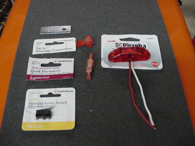

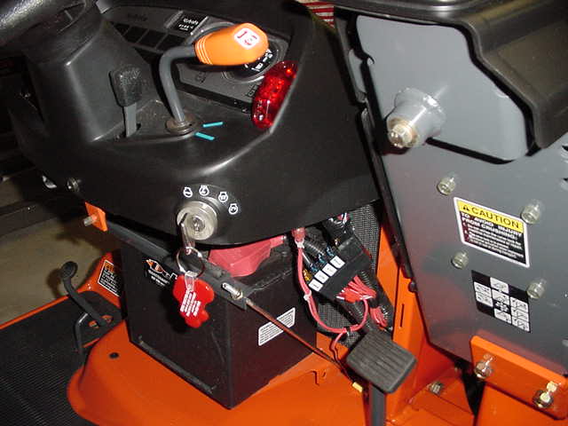

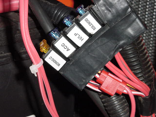

Parts from Radio Shack (Tap-in Sgueeze Connectors, PN 64-3052
Fully Insulated Crimp Quick Disconnects PN 64-3131, SPDT Submini

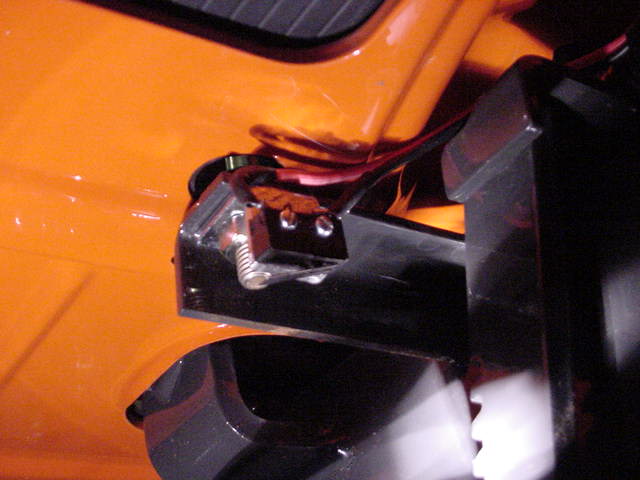

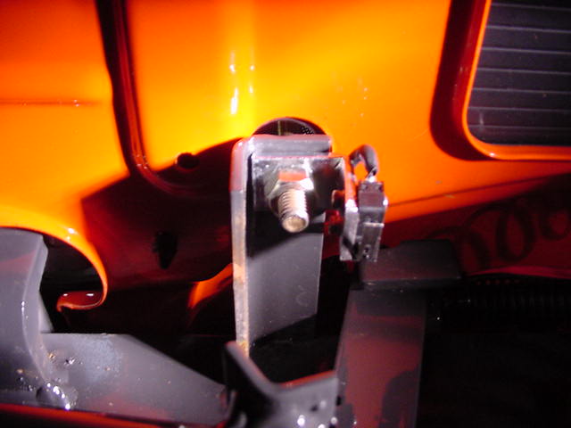

Lever Switch PN 275-016A) and wire . The Light comes from wal-mart check for trailer lights ( Piranha LED V168R light. The metal bracket is 2- 1/4" Long by 3/4 " wide bent 90 degrees on center as for how water proof the switch is that I do not Know . I used them in my RC Scale U Boat and never had a problem and there was a lot of water leaks on this sub
/forums/images/graemlins/crazy.gif I took some brighter pics hope they help. /forums/images/graemlins/cool.gif

I finally got around to doing this project. I did not use the same red light, I found a smaller one at Radio Shack and mounted it on the side. I do not know why Kubota does not make this standard equipment. The set up works great! /forums/images/graemlins/grin.gifNo more driving with the break on. /forums/images/graemlins/blush.gif
