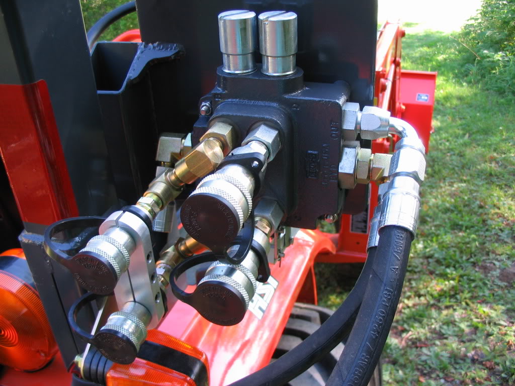

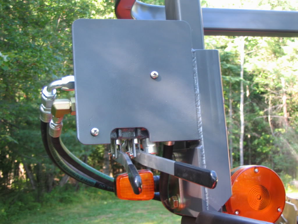

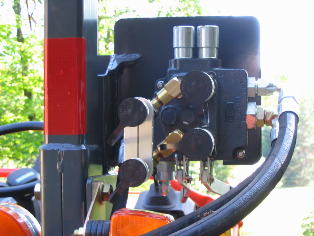

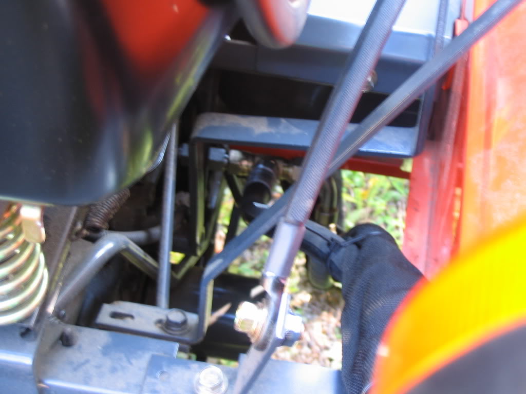

Here's how I did it on my B-7800. It utilizes a Cross AD series 2 spool valve I bought from Messicks..

-PB (also labeled BYD) from the loader valve to the IN or P (pressure) port of the new valve.
-PB (BYD) on the new valve to wherever the line was connected from the loader valve.
-OUT or T port to the tank, and yes-it can be Tee'd with the one from the loader valve.
As for QD's, I would match whatever you have now for your, Probably Pioneer's or Safeway"s.
A smaller, more compact (and more expensive) is the 9-4501, but the one you linked will work fine.
As for a "parts list"...good luck! We all had to learn the hard way also!;) But seriously I doubt anybody will have a detailed list of everything they used.
