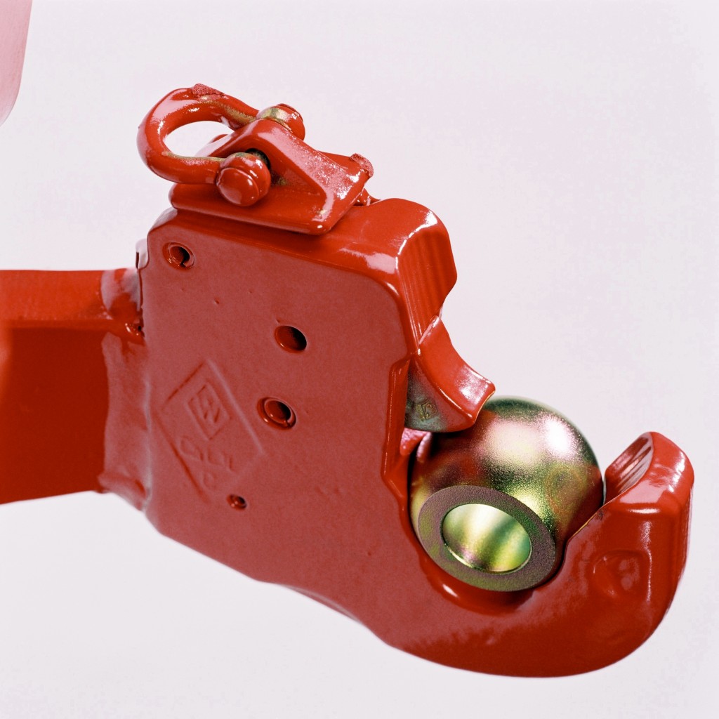

Take a look at the Euro hooks. It does require some cutting and welding but works sooo good. Several happy users here on TBN.
Doesn't extend the lift arms like the Pats or other QH do, therefore doesn't reduce the lifting capacity of the 3pt. It's very easy to connect. The balls offer freedom of movement, so it doesn't bind or bend pins. It's very robust and strong.
